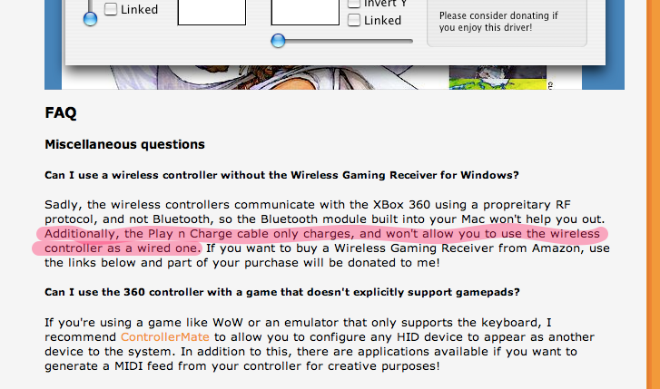

Tried following thed0ctor's instructions, but when I get to this bit
Now we need to change the vendor and product IDs to match your controller.
Plug in your 360 controller.
Click the apple icon in the top left corner of the screen and go to "About This Mac"
Click more info->system report-> USB
Find the 360 controller and click it.
I can't proceed since my 360 controller doesn't show up in the system report. Indeed, that's just the problem, getting the device recognized by my Mac.
I'm on a MBP81 (13" early 2011), running 10.9.1.
wow - how did I miss this?!!
Here lies the problem! :rolleyes:
attachment.php
