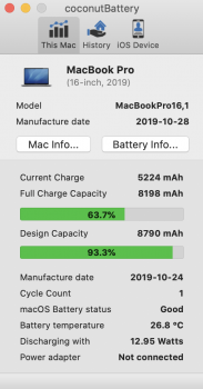

I was checking the battery capacity last night on my new MBP 16 and I was surprised to see that it was already down 8% from the design capacity. I’m trying to recalibrate it at the moment and zapping the PRAM and SMC to see if that helps. If not, I’ll have to return the laptop because I don’t think it’s acceptable to have such a drop in capacity after only 4 cycles. What do you guys think? Is this happening to you as well?

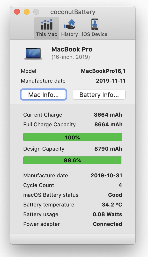

got my 16" today.
97.1% out of the box with one cycle on a battery produced 9 days ago. Shut down for a couple hours, restarted, now 98.6% with still 1 cycle.
I'm expecting it to go up after a few cycles (but yes it sucked to see).

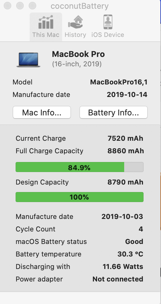

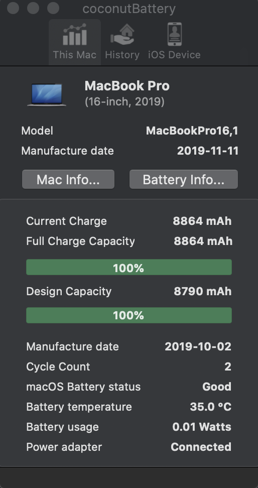

Thanks Mike, seems you were right, I'm now in a much better position after recalibrating the battery 😃! It had me worried for a while...

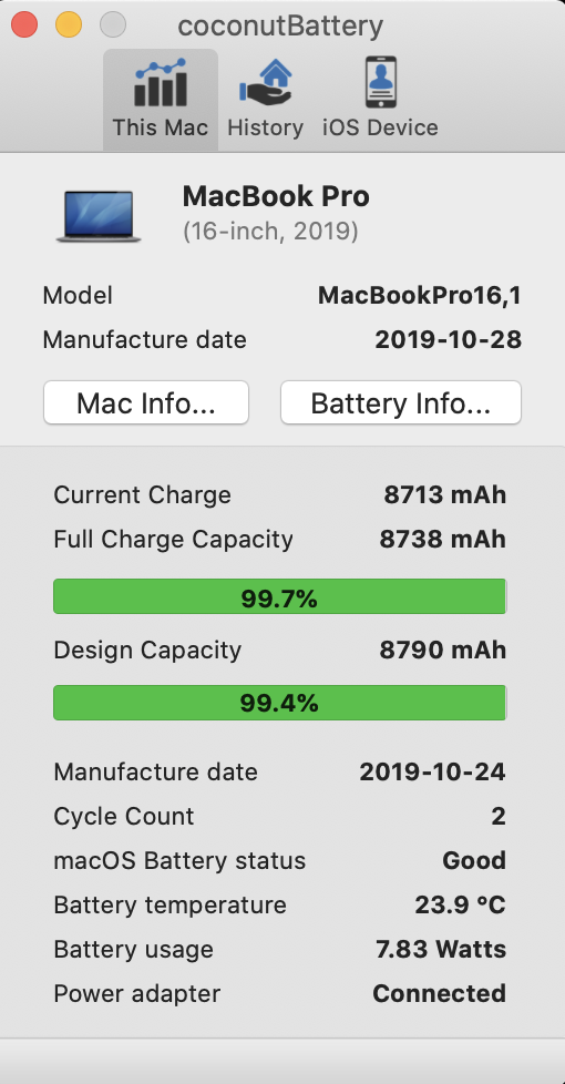

Just received my MBP 16" and it also has low battery design capacity. What do you guys meany by recalibrating? Drain it fully then recharge?
Yep let it die (run on battery until the Mac turns off), then plug it in and don’t unplug it until it’s full again + 1 hour more, to fully complete the charge (macOS 100% is not 100%, use coconut to be sure). That’s how mine was fixed. Since I sent the screenshot my capacity is back at 100% 😎

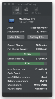

Mine is at 88% (7736mAh), 9 cycles, and calibration + reset SMC controller didn't fix the issue...
EDIT: after an hour the battery is at 99% again! Nice!

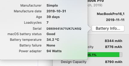

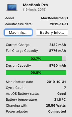

See below, this is now how my 16" behaves consistently:
The battery is charging at the moment and is not full yet - 92.7% (if you were calibrating, that's the number you want to wait to be at 100% before unplugging).
The design capacity is the same on all MBP 16": 8790 mAh.
The "Full charge capacity" is the usable capacity, and mine is now at 99.8% (8776 mAh), which is normal after 39 days (age of the battery).
Hope that clarifies things a bit.
Reactions: Meuti

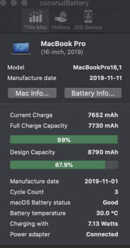

I am at 7730 mAh full charge capacity after only 3 cycles. Can someone please walk me through what I need to do specifically to correct this?
Thanks
EDIT: It's fixed after doing full cycle and 1 hour past.

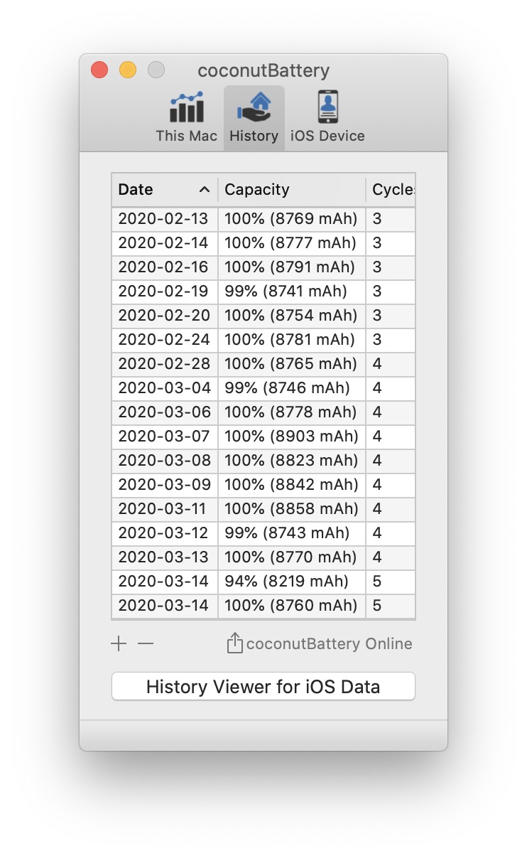

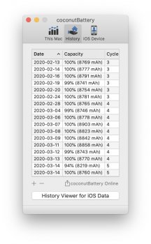

I was folding with a 60W GaN charger instead of the factory one since the max DC power drawn was observed at about 50W. Yesterday when I checked battery health on iStat menus, i was freaked out it has lowered from 100% to 94% in just 4 cycles. Then I happened to see your experience here. Having it back charging with the factory charger for a couple hours, battery health is back to 100%. I think every MacBook owners need to note this.
