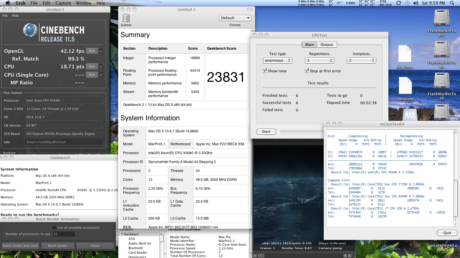

Oh man what do you feed that thing? 40k overall and 68k floating point score. That's practically a core2duo era server farm. Care to post about the build😀?
It has two underclocked/turbo biased 5680s who reside on an EVGA SR2 mobo. So it not so much what it's being feed as much as what it isn't being feed. Overclocking requires high Vcore/ high Vcore requires more power -> more heat -> throttling. Underclocking keeps Vcore within CPU's spec VID/ lower Vcore doesn't require as much power -> more cool cores -> more turbo boosting potential and with a turbo ratio of 13 13 13 13 14 14 because 3.33 GHz chips are being underclocked to run at <2.5 GHz. It's on a reduced power, current, heat, and throttling diet. See, for more info, https://forums.macrumors.com/threads/1333421/ . The performance of other reduced consumption systems can be found by clicking on the URL in signature line.

Below is an old pic showing the system report page of FrankMacWinTosh (aka FrankHacWinTosh) [and now known as WolfPack1] while it was running (all at the same time - low scores to prove it) (1) CPUTest, (2) Maya [rendering an HD animation at the rate of 1-3 seconds per frame], (3) Cinebench, (4) Geekbench and (5) mCoreTest64 and the results thereof. Non-abused Cinebench and Geekbench scores -> sig.
