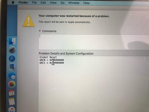

Have had kernel panics before, but today it wouldn’t wake up at all. I could get it to come back via an SMC reset, but the minute i plugged a peripheral in, it crashed. Tried again with reset, restarted, but nothing. Now, the SMC doesn’t even seem to work.
I’ve also tried the NVRAM reset (with Apple Support) and no luck. I suspect this is all tied to the use of an external monitor, but that’s just a guess. I have tried am the reset with everything unplugged as well as with power connected, but no luck.
I can’t even get to where I see an Apple logo anymore.
thanks for any help.
So after waiting about 30 minutes, it started up. What I’d like to do now is run whatever diagnostics might be helpful to prevent it from happening.
I’ll take all ideas on that, too. This is all the crash log showed:
