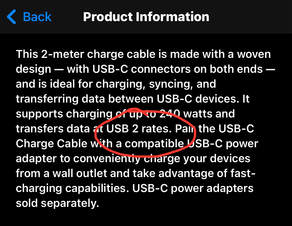

Reactions: zapmymac
At the time those were released, USBC only allowed 100 watt charging. The standards have been updated to allow higher power charging, so Apple added support for the new standards in the new hardware.
This is very confusing because even Apple's own product page about the Thunderbolt cable specifically says it's limited to 100W. The fact that USB-C can charge at more than twice that is news to me.
This seems to be entirely dependent on the cable, and the cable listed in the article seems to be the only one that can do it. Didn't know this was part of the spec now. As if it weren't confusing enough already.

The Thunderbolt cable has its own specs that are different than the MacBook’s specs.
The Thunderbolt 4 cable from Apple is 100 watts limited and always has been. But the port on the MBP 16 M3 now supports 140 watts. If you wanted to use Thunderbolt with 140 watt charging you need the Satechi TB4 cable which has up to 240 watts, plus whatever supplies 140 watts over Thunderbolt if it’s a data device, I think the posted Dell 6k monitor is currently the only one (Everything else is just a charger, not data device).

It's not a thunderbolt cable, USB C can be confusing.

From what I’ve heard, the difference between 100 and 140 watts is negligible. The MacBook mostly uses 140 watts for the fast charging feature, if you plug in 100 it’s capable of doing all the same things with the CPU/GPU/storage, it just won’t fast charge while doing it. It will still charge, too, just take an extra hour or 2 to do it.
