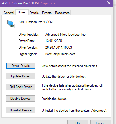

I get 3 watts in windows on MBP 16” with external monitor
I used third party AMD drivers
You can install hacked Bootcamp drivers and they are far more efficient than the stock Apple-provided one. Once you install those, Bootcamp is actually much more efficient than Mac OS when multiple monitors are connected.

What do you get in macOS? Why third party drivers? And which?
I get 18-20 watts in macOS.
I use third-party drivers cause they seem to be the best lol.
