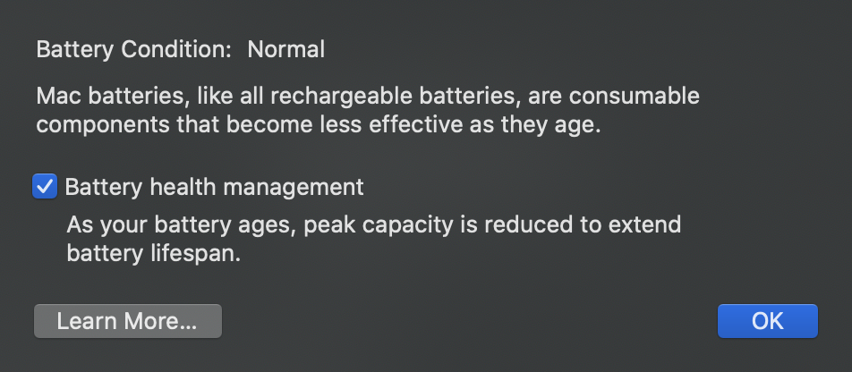

Anyone have the issue where the MBP 16" loses power while NOT plugged in? And I don't mean a little but after three days not plugged in a 100% battery is at 0% and won't even start. That just shouldn't happen like that.
Were you able to repeat this?
Yes, have noticed some power "burn off" or whatever you want to call it after machine is 100% while plugged in and turned off (fully shut down, then wait, and not just close lid). Never notice less than 93% remaining. There absolutely is battery management going on in the background. It is irritating, but believe it's all battery health related. Going down to 0% sounds like something else going on entirely.
