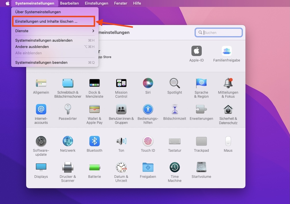

That's normal. Re-installing the OS doesn't wipe your data. It just installs a fresh copy of macOS, everything else remains untouched.
If you want to start from scratch, go to system settings and click on the main menu entry. There is an option to reset your Mac.
Also, your EtreCheck report doesn't help. You should share the panic report instead.
