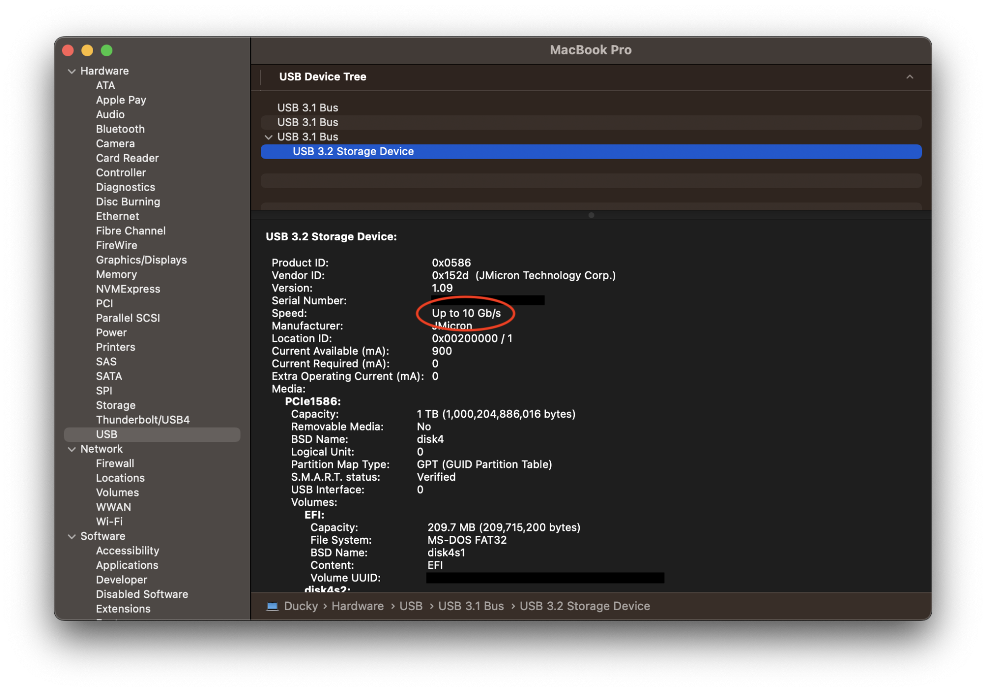

I testing a Gen 2x2 enclosure today connected to a 16" MBP M2 Max and it only enumerated the port with a 10Gbps link speed.

macOS does not support USB 3.2 Gen 2x2. So, you can only connect at Gen 2 speed (10 Gbps). I am not certain if this is a hardware limitation or a driver issue.
