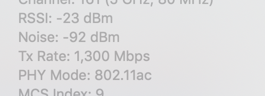

No, that's pretty routine. This is my 2015 MacBook (if I'm close enough to the router)

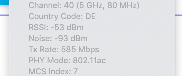

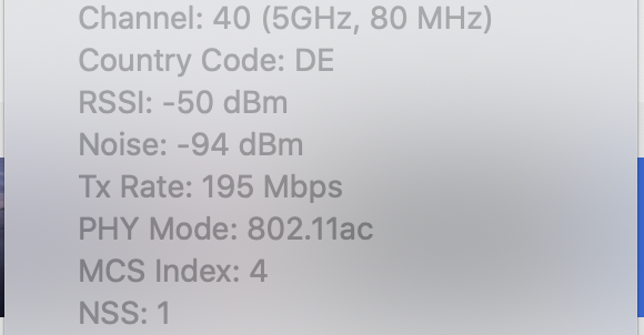

I did a lot more testing in the last hours. Changed almost any setting on my Orbi router. Bottomline, I see about half of the Tx rate on my 16" compared to the old 13".
16"
13'
What caught my eye was the 16" jumping around with the Tx rates a lot more than the 13". I really don't know what's wrong here, but I'm a bit worried now.

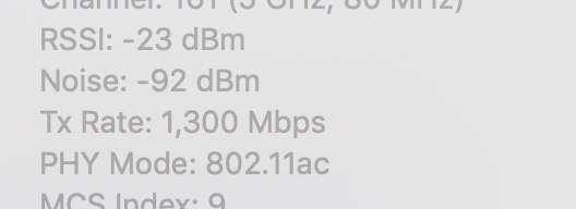

Mine is similar to Howard's, I see Tx values of 1053/1170/1300 when in the same room as my old ac TimeCapsule router.
