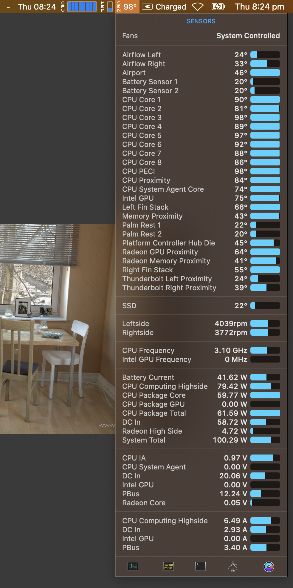

So I did a Cinebench test, and found something interesting and concerning.
According to iStat Menus, the "DC In" figure was just under 60 W, and it reported "Battery Current" at 42 W, for a "System Total" of 100 W.
If this is true, it means running the test indefinitely should drain the battery quite quickly; as some people seem to be reporting. I'm astonished if Apple has done this. It reeks of the cost-cutting and experience-cutting we saw in the 2016-19 MacBook Pros. This should get widespread coverage.
Has anyone replicated this and found a cable that delivers 96 Watts? If so, I'll be making a claim for Apple to cover the cost of such a cable.
I'm trying not to jump to conclusions, but I fail to see why iStat Menus would be wrong, unless I'm reading it wrong.
There is nothing wrong with this (assuming it's a momentary snapshot and not max what you are getting in). The power controller will balance stuff up and down to preserve battery health — especially if the battery is so close to its maximal charge.
It won't drain the battery unless your are using wrong chargers or your machine is defective. Try it out.
What reeks is the fact that they sell charging cable separately. Everything else is working as it should.
Cables that deliver 100W are included with your Mac. And no, I have never came across a new MBP that would discharge its battery under heavy load when plugged in — and I have tested dozens and dozens of them.

Yes, I posted a bit too early. I was able to draw > 90 W plugged into the right side. However, if that isn't possible on the left side, that is news to me. I don't recall Apple publicising that only certain Thunderbolt ports can function at full power.
I would say from the screenshot that it looks like either a 60w charger or cable is plugged in.
OK, that does indicate a possible fault or issue somewhere then, as all ports should be able to do full draw, and indeed do on my 16" certainly.
That would also indicate it probably is laptop at issue not the cable, contrary to other statements made.
"Has anyone replicated this and found a cable that delivers 96 Watts? If so, I'll be making a claim for Apple to cover the cost of such a cable."
is contraditected by you stating on right side ports you got over 90W...

It was not a momentary snapshot. The test takes a few minutes and it was very consistent during the test. Further, if it is normal to try and balance DC-In and battery power, that doesn't explain why it decided to (consistently) draw > 90 W from another port.
And the fact it can from another port indicates the cable is not the issue, and that there is an issue.
Try an SMC reset, it could be something glitching in the negotiation.

I've not been able to replicate it again. Who knows. You might be right about it "wanting" to draw a little bit of battery power.
So I'm not worried. The cable and power adapter are obviously fine, and I've not had problems with excessive battery drain. I think "Dr. MacRumors" has fuelled my anxiety in this instance.
Thanks for your help.
I suspect (as others have reported in this thread) that there was an issue with the Mac incorrectly recognising the power supply as a 60 W power supply or the cable as not rated at 100 W.
Before I ran the test, I was surprised and concerned to see that iStat Menus reporter it as such. I’ve since discovered this is not a permanent issue, but I’m unsure how or what triggered it.
I’ll certainly keep an eye out for it. Hopefully it was a rare issue. It was wrong for Apple to tell people that a maximum of 60 Watts power draw from the adapter is normal behaviour.
