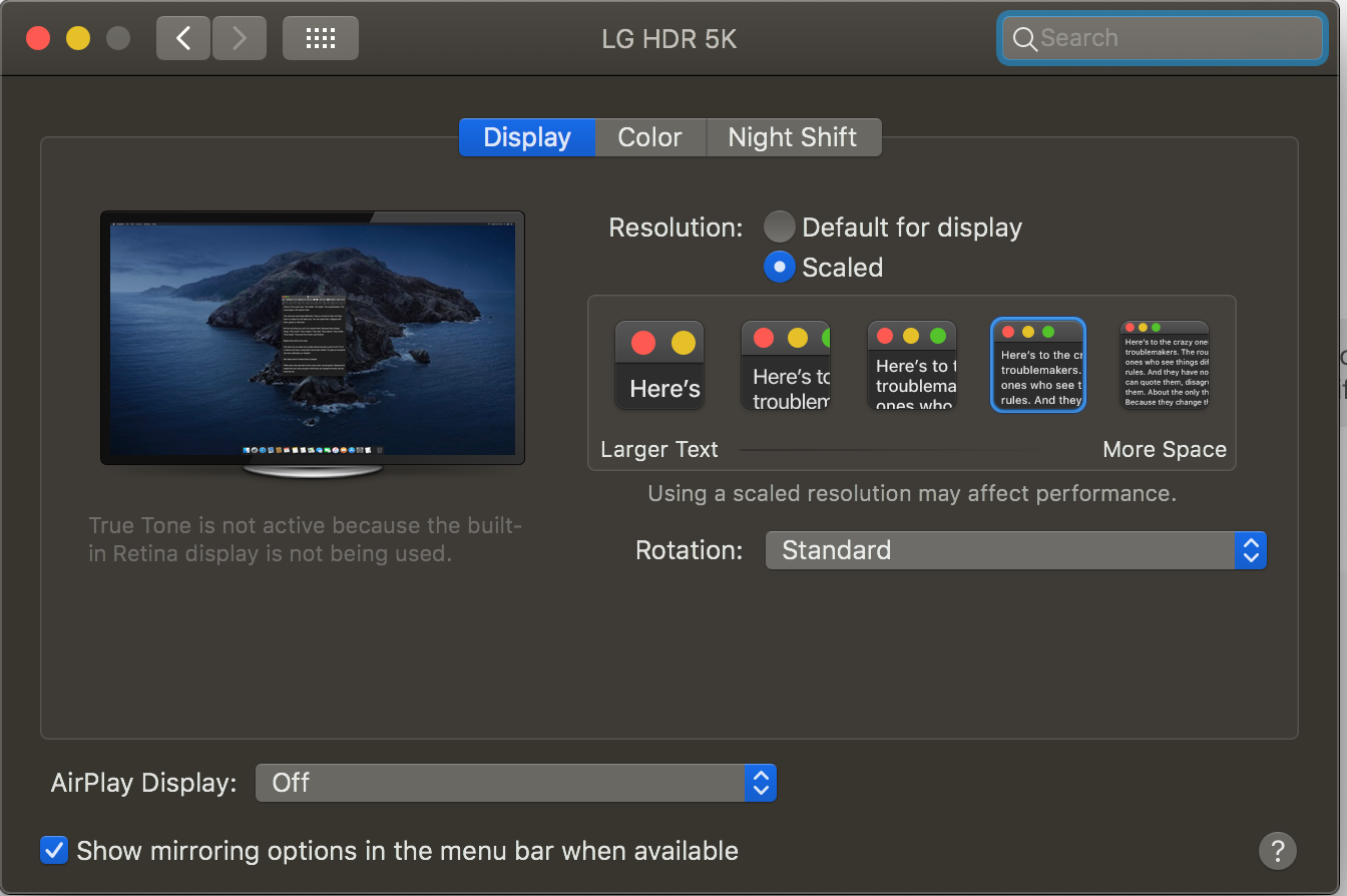

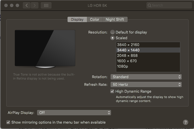

That's the first thing I check when I experience the issue. I attached a couple of pics, the first is when it's working just fine and the second is when it has issues.

Is that correctly identifying the monitor? LG HDR 5k seems incorrect - can you try holding down option while in the Displays preferences to get the Detect Displays button to appear.
You could also hold down Option when clicking on the Scaled button in the resolution section to present more options.
I think I read something somewhere that Catalina on MacBook Pros changes the default resolution to a scaled one for more desktop real estate rather than going for true retina for clarity. The right hand panel is not showing the maximum resolution possible which is a concern.

When I hold option down and choose Detect Displays it still says 5K HDR. Is it because my 5kk2k is the business version? I have to edit the OP cause I actually have LG 34BK95U-W but I'm not sure if that has anything to do with my issues.
