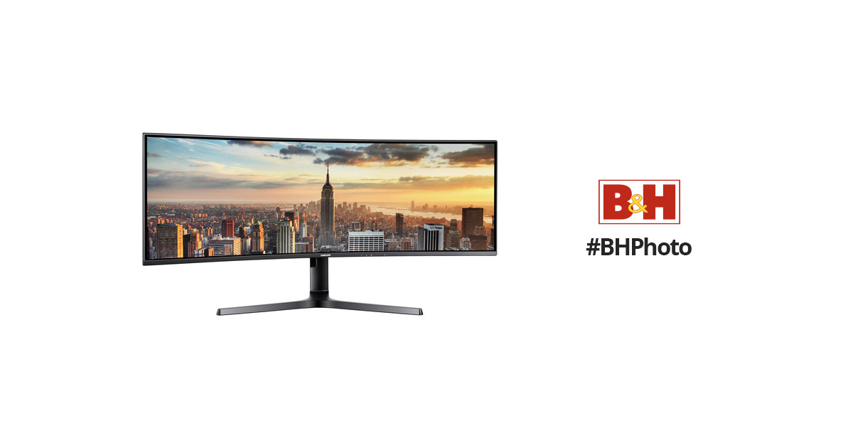

Hello friends- I have an interesting problem and I want someones opinion on it-
I had a higher end MBPro 16" i9/1TB/16GB/5500 model that I was using regularly with my external monitor connected directly via USB-C cable. After 2 months of use, the USB-C ports on the left side of the MBPro (same side I was using the monitor USB C connected to) died. The ports stopped recognizing the USB C connection from the monitor, and stopped any USB-C devices connected, including the Macbook Apple charger.
Last week, I was able to replace that model with a new MBPro 16" (same specs as previous), and started using on same monitor 2 days ago. After 1 day of monitor use, again the USB-C ports on the left side of the MBPro have now died. They no longer recognize the monitor or any other USB-C devices I plug into the left side, but they recognize the Apple charger so the macbook pro can still accept charge.
I have tried SMC Reset, Safe Mode, PVRAM,NVRAM, everything.
Is it the monitor causing my problem? Is the USB-C connection from the monitor somehow messing up the internal logic board usb-c bus by charging less or something?
Specifically, should I not use USB-C cable with it to connect to macbook pro now anymore? What's the alternative if someone can link me a better cable/dongle/product to connect to the monitor? Idk what to do anymore and this is very frustrating. Monitor I use is Samsung 43" CJ890 UltraWide display.

It says on the monitor website "The USB Type-C ports have a power output of up to 100W to provide juice to a variety of compatible devices." Is this good?

100 watts from a single port is sufficient provided that is a single port and not total for all devices. If that is a single port, my next question would be if the included cable supports 100W. That said, I would not personally use this display to charge the device at this point.

The USB-C to USB-C cable that I was using came with the monitor itself, so I would think that it would be able to support the 100W right?
Theoretically, there shouldn't be any issues with using a displayport-USBC or HDMI-USBC cable with this monitor since those dont affect charging or power draw, right? I'm planning on using the dispayport-USBC on the left, and charger on the right once I get this laptop replaced.
I'll try to see if Samsung will do anything about it, but the display works great otherwise. This is just an interesting issue. I'm fine with foregoing the 1 cable setup and using a displayport-USBC if it will prevent any issue.

After doing some research, I have now found out that others have had the same issue, with the same monitor by using USB-C-USB-C cable:
So now this is a confirmed problem with this monitor when using USBC to USBC cable (same one that comes with the monitor). I just wonder if this can be prevented by using HDMI to USBC or DisplayPort to USBC...
Hi, last month with two of our macbook pro's on both one usb-c port got fried with this monitor. We already tried changing the usb-c cables and switch from multiple macbooks. Without any effect. Some strange thing that i noticed is that we can't set the monitor to 120hz anymore. When switching to the 15W usb-c port, the option is available. Also charging the macbook with the usb-c cable connected to the 15W port is terrible, because when plugging an extra power adapter wont work...
I thought I was the only one! I had this same issue after I received my new MacBook 16” around April this year. Suddenly the usb-c ports on one side stopped working. Whilst on the phone to Apple Support, the second side stopped working. After 6 weeks having just about every major component replaced, it was working again, and then once plugged back into the this C43J890 monitor using the usb-c cable that came with it, it stopped working again, and actually started smoking whilst on the phone to Apple Support. Finally got a new replacement and have plugged it in with HDMI with no issues, but Samsung support were beyond useless. They couldn’t tell me what cable I can buy that should work, flat out denied it could be the monitor causing the problem, and wouldn’t help any further.
I’m now in a situation where I need to plug a third device into the monitor, but DO NOT want power delivered over USB-C. I have one device on DP, one on HDMI, and would love to know if anyone has experience using a cable that can use USB-C for display output only, without power.
I think this is not possible. This should be controlled inside the display. But disabling the charging capabilities is not possible on this monitor...
