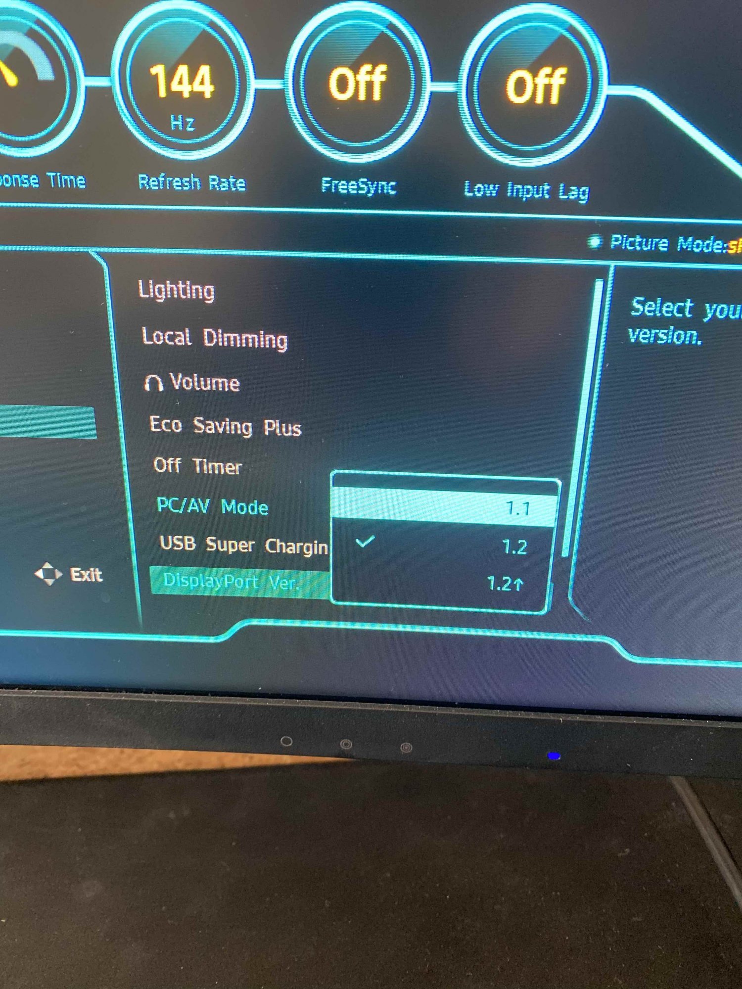

So I figured out the problem with the flickering. I changed my displayport version from 1.2+ to 1.2 and the problem went away. TBH with sidecar at my disposal I never dock my 16MBP but if you are experiencing flickering I would suggest toggling through your monitor settings.
