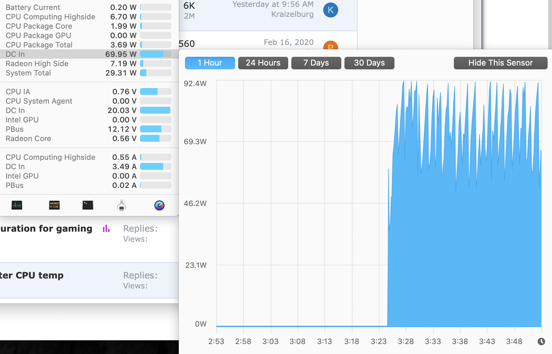

I've noticed that the stock 96W power block for the 16" MBP isn't able to sustain 96W charge rates, is it only me? When I'm connected to a 60W or 85W charger, I don't see power delivered this way.
I can't recall exactly, but I had 1h 15m left more or less, I guess around 20% or so, and was using the Radeon 5500M graphics card.

It's possible it can't throw that much into the battery, and the extra overhead is for power consumption for the system while it's charging.
Looking at this again. I wonder if it needs to maintain peek charge rates. After all once the battery is full, it is full. Until something drains it down there is no need to charge. So to me it seems like the charger outputs full rate until the battery is full, and then steps down to a lower rate. They when the battery charge drops enough the charger steps up to the higher rate. Repeated over and over.
The reason the lower output chargers continuously output at max rate is because your load is high enough to prevent the battery from getting full.

Try this. Run what every load you are running. Unplug the charger. Let it run the battery down for a bit. Then plug in the charger. If it shoots back up to high charge rate good. And if it starts doing this cycling after the battery is full the mystery is solved.
What you’re seeing is how much power the computer is asking from the power supply. It varies based on all sorts of things, mainly cpu and gpu load and battery level, it doesn’t always need 96 watts.
In fact under a high load these computers will actually take more than 96 watts and then they’ll start draining battery power while plugged in.
Yeah I figured the machine doesn't really need sustained 96W.
