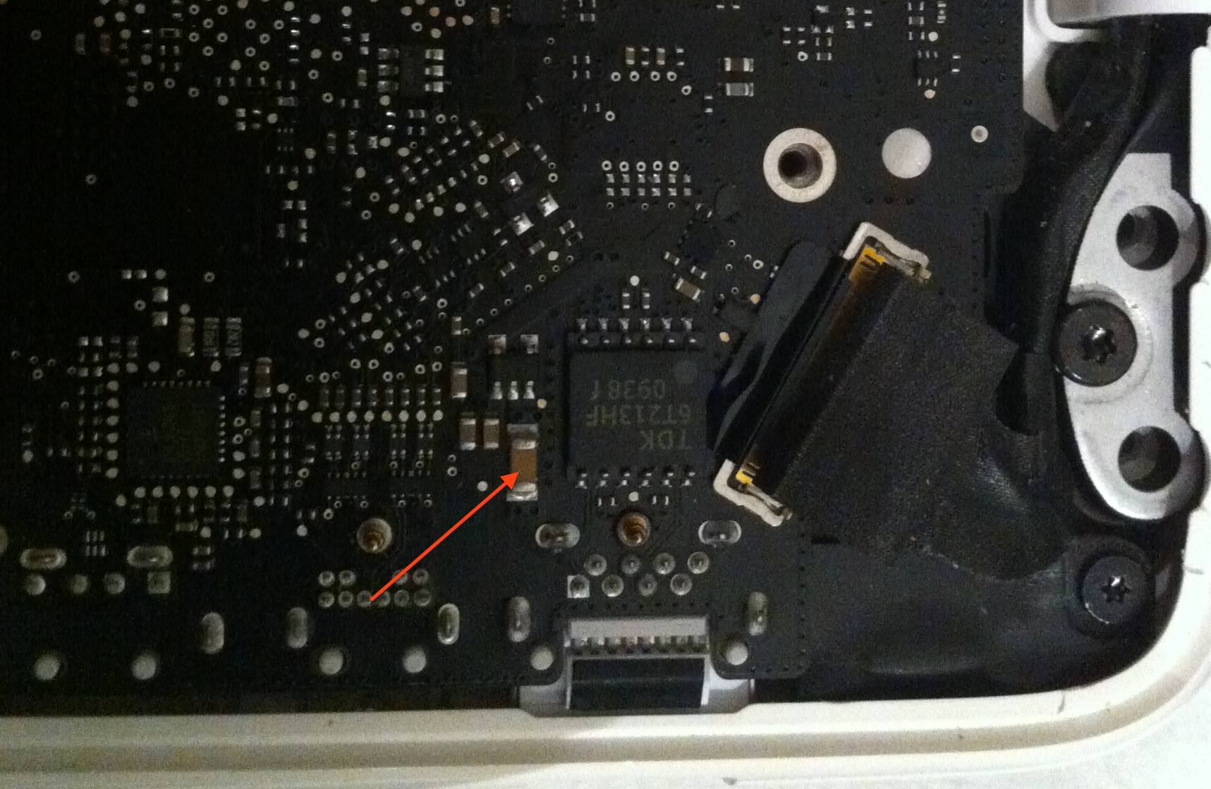

Hi everybody!
Mi MacBook A1342 is fault. I have tested various components on the logic board and i found one not responding at my tester. Can anybody please test it for me in a working motherboard? And what kinda component is this? Fuse? Capacitor? Diode?
