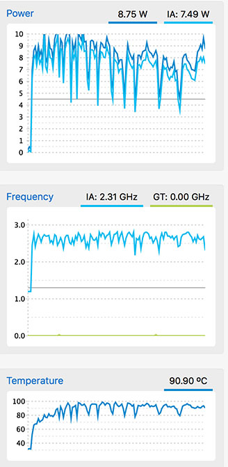

I have the 2016 12" MB, highest configuration (512GB SSD, 1.3GHz/3.1GHz turbo). If you are running any large datasets, you will be very disappointed in its actual performance. The reason is throttling due to wholly inadequate cooling. In fact I've never seen my 12" MP manage to turbo all the way on up before throttling even in air-conditioned environments. So that 3.1 GHz turbo figure effectively is fictitious. Intel's Power Gadget will tell you Power/Frequency/Temperature of the CPU in real time. 2.4 GHz is reasonably sustainable on mine. Since they haven't changed the design much, you're not likely going to do much better on your new machine than on mine.
The turbo boost spec figures are 3.1/2.7 for single/multi core.....see https://www.notebookcheck.net/Face-Off-Apple-MacBook-12-Core-m3-Core-m5-and-Core-m7.172046.0.html
Throttling depends what you are doing. See https://forums.macrumors.com/thread...n-about-cpu-throttling.2017759/#post-23986887
Not an apples to apples comparison, but my Dell XPS 13" 9360 (with Ubuntu) exhibits a wonderful thermal design compared to my MacBook 12 (2016). Running the same program that showed throttling on my MacBook on my diagram, the Dell managed to hold onto full turbo boost clock frequency as long as needed. The Dell has a more power-hungry CPU but it does have a fan. Apple should have designed the MacBook to be better able to cool the CPU. Being slightly thicker and heavier, with a better heatsink or a micro fan would allow it to properly cool a 4.5W TDP class processor. And I'd be a more satisfied owner.

Unfortunately, the 13" with the touchbar wasn't out when I got the 2016 12". I love the 12" for its portability. I use it for conference travel and prototyping my code. I just wish they had done a better job of designing around the TDP of the intended CPU class (5W).
