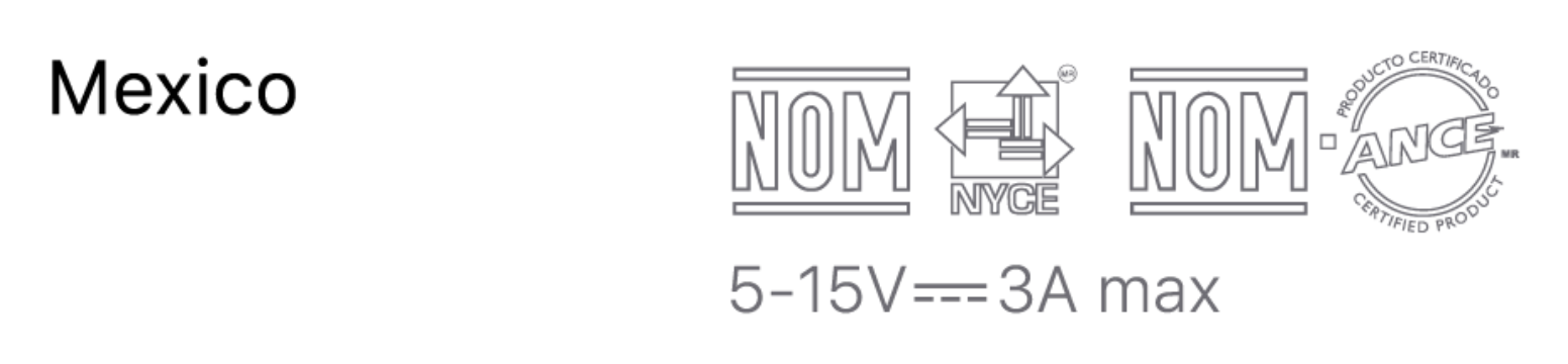

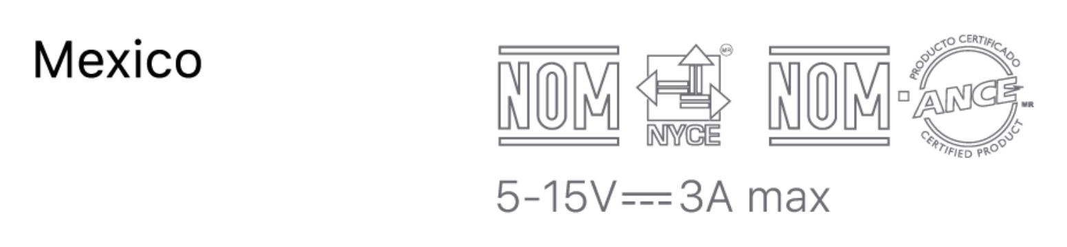

The "45W" is more of a limit, as I understand it. Previously, iPhones used the 9V x 3A USB-IF profile (which allows a maximum of 27W), where 3A is the maximum for normal USB-C cables.
USB-IF only has 5V*3A, 9V*3A, 15V*3A, and 20V*3A for most chargers (using the traditional fixed-voltage system). 12V is optional & thus rarely used.
5V*3A profile: 0 to 15W (3A) charging
9V*3A profile: >15W to 27W (3A) charging
15V*3A profile: >27W to 45W (3A) charging
20V*3A profile: >45W to 60W (3A) charging
So for Apple to even want 28W charging, Apple had to move to 15V and that profile allows up to 45W.
28W = 9V*3.1A = this violates USB-IF spec; you cannot exceed 3A
28W = 15V*1.9V = this is within USB-IF spec; it is below 3A
https://regulatoryinfo.apple.com/elabels/A3292 (can't find an active one for the 15 Pro, but I imagine it is 5V-9V⎓3A max).
