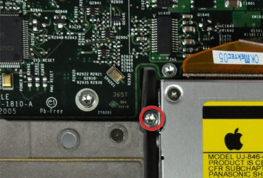

Where are these SYS and PMU reset pads?
Service manual, page 156: https://powerbook.micahgartman.com/ss/ss_pbg4_17_dl_167_15_133ghz.pdf
I don't see SYS_RESET but the A1138 service source also made no mention of it. Don't know what PMU_NMI is (Non-Maskable Interrupt perhaps?), mine doesn't have it.

I found a close of up of the correct portion of the board online showing the reset pads (for anyone looking to do this as well look to the lower right of the large black chip in the upper left corner of the image):

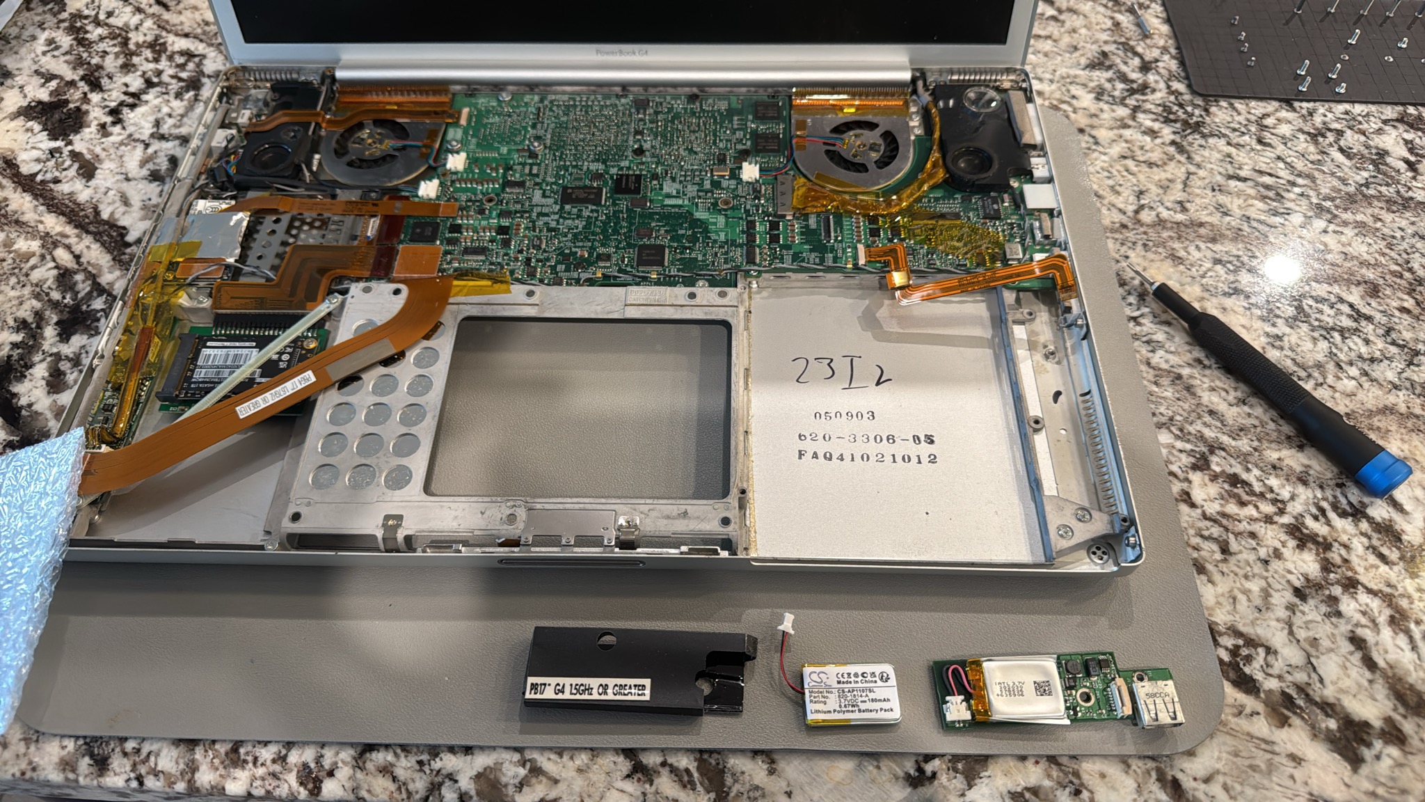

The battery came in this week and I had a go at installing it:
The new one is between the black plastic shield and the USB board (which in the image still has the original battery installed). The old one was stuck down pretty hard! I pried it off with as much shearing force as I could with a plastic guitar pick but even then the foil cover distended a fair amount.
I did get the new battery in place and the USB board reinstalled along with the Super Drive.
Sadly, I haven't had any success with getting the PowerBook to boot. I did the System and PMU resets many times and checked booting with the Power Btn pads (which do act as expected). No change in behavior.
I also tried unplugging each of the HD and the SD components to see if that made any difference -- no change in behavior.
After giving up on the logic board reset pads I reassembled everything and tried the no battery or AC 5s power button press. The machine still won't boot. It did run the fans full blast for a short period which I believe indicates a PRAM reset was successful and the optical drive now runs long enough to sound as though it is trying to boot from the inserted disk (which I still can't remove!) but otherwise it is the same.
I'm leaving it plugged in just in case that new PRAM battery needs charging to do what needs to be done but I'm not sure what else to do.
