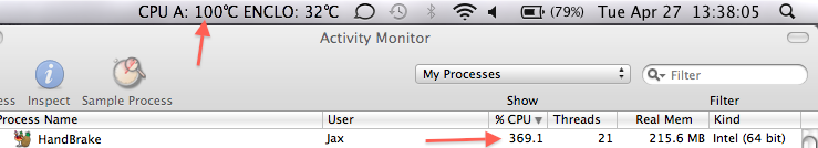

Now when I was using HandBrake, it got quite toasty. 😉 (See attachment)
But that was with the CPU running at literally 98-100% and being overclocked. So, they can get hot, but I just turned a portable fan on and pointed it at my MBP and it dropped the temp to the mid 80's.

MBPs have always been able to reach 100 C briefly when you redline the CPU. The Core2Duo models do it and it seems the i7s do as well. My C2D 13" does it, lots of others posters' on here do it as well. Then the CPU falls back to about 90 C.
So the article could have been written about any of the millions of MBPs manufactured in the last two or three years.
Nothing to see here. Your i7 will be fine, it will get exactly as hot as the millions of other MBPs out there. AFAIK there are no systematic problems with them.
