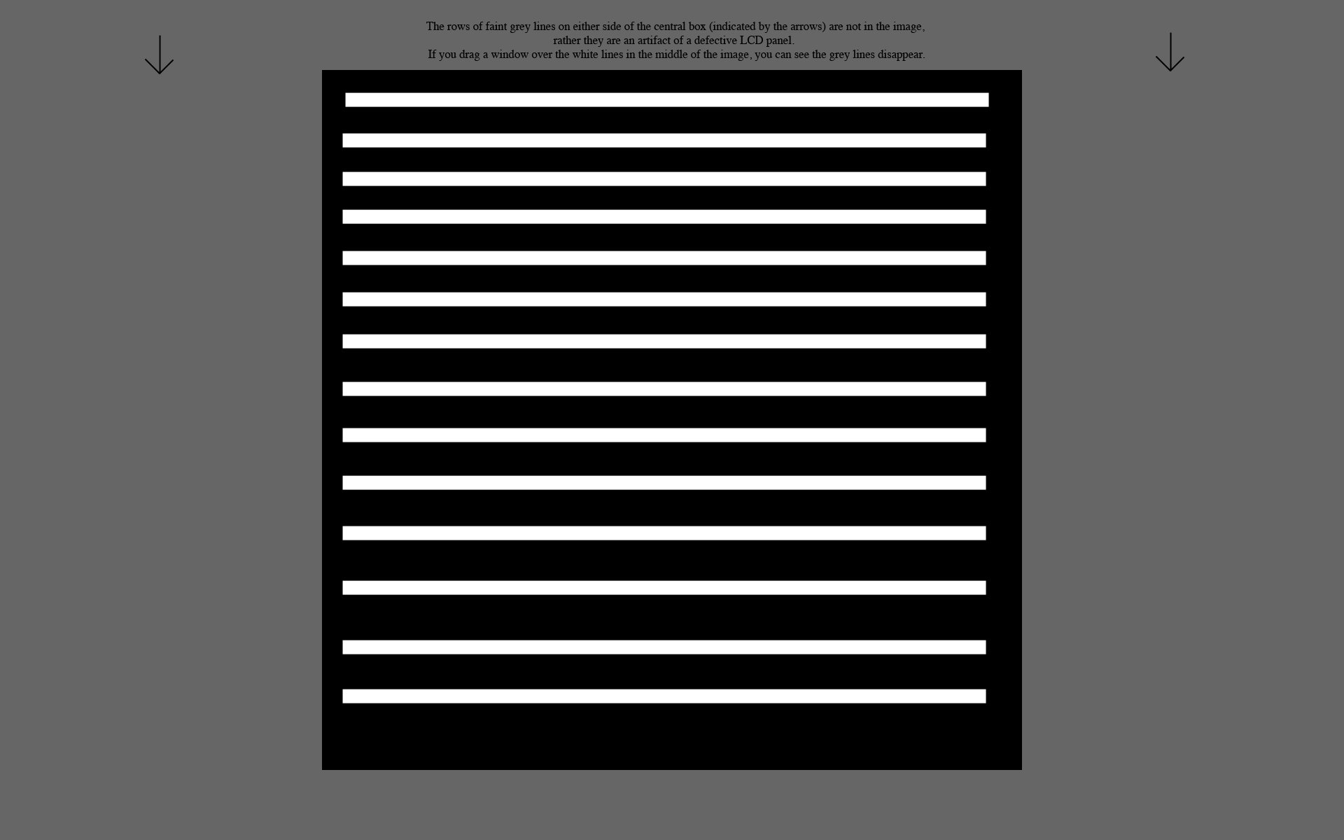

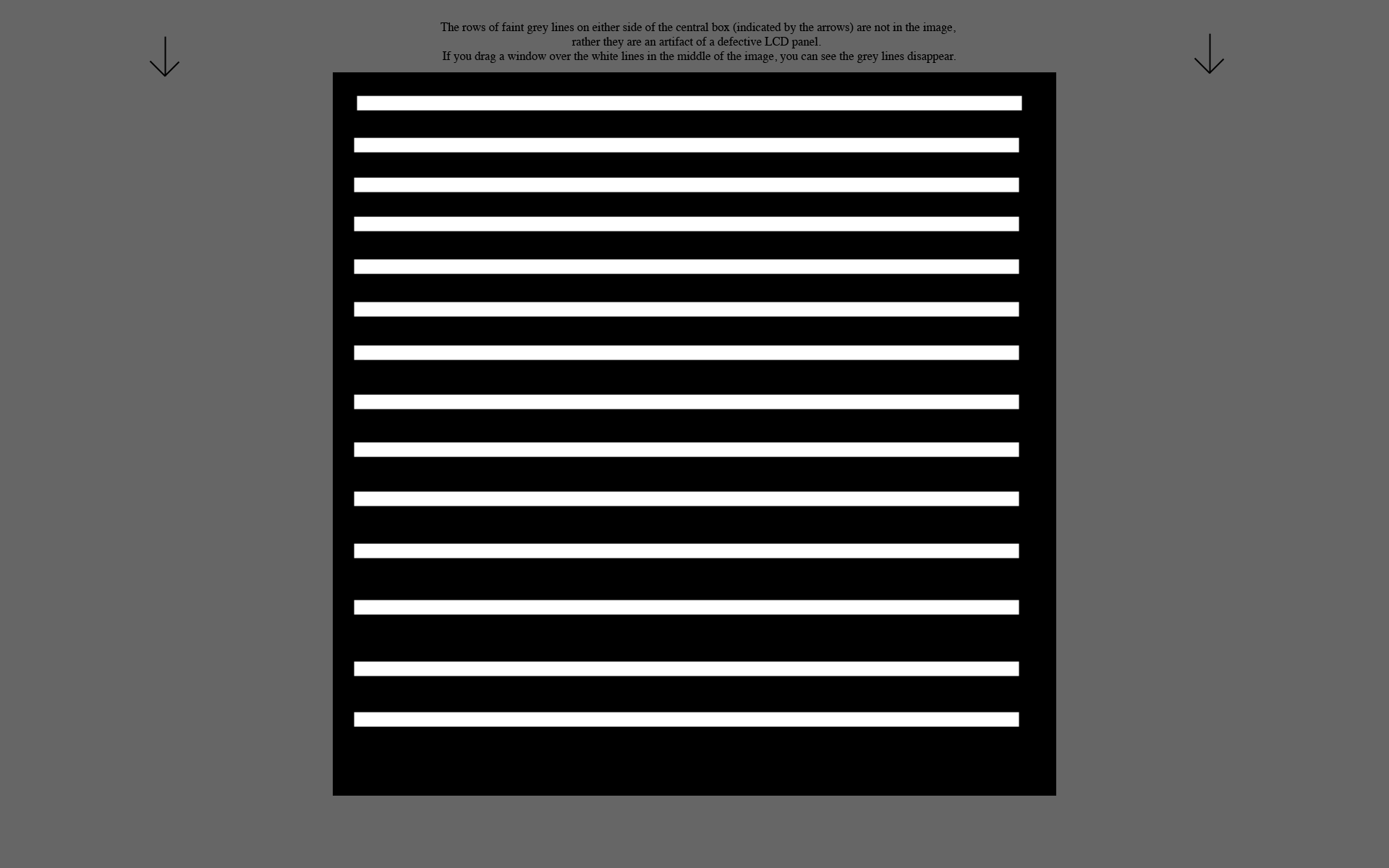

sorry to resurrect and old thread, but I've a notice a new problem with my display that I think may be related to the line issue. I'm experiencing heavy crosstalk (looks like a kind of ghosting). I wonder if the OP could use the included image as a background and see if his machine manifests a similar problem. The image should generate rows of faint grey bands on either side of the central white lines. There is text in the image and arrows indicating the defect, should the defect appear.
ive got a macbook air with a 9C90 screen with lines and i can see that crosstalk on it, so maybe that is a possible indicator for bad MBP screens as well, as i know my airs screen is garbage
