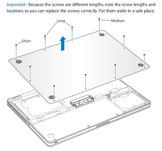

One thing I would like to ask is, when i screwed the bottom back in, one or two screws didnt go in exactly the same way as I took them out, even though I put them in the same holes for sure. 8 of the 10 screws go below the surface, so when you rub your hand against the bottom you don't feel them (just like it was when received and bottom was not opened yet), but 2 of them you can somewhat feel.. meaning they didn't go completely below the surface like it originally came as.. but they are tight and not going to come out unless I unscrew it.
Appearance wise it looks fine, just a texture feeling if your hand touches the bottom of the laptop you can feel those 2 screws a little. Is that okay and normal? I tried screwing and unscrewing it many times and got the same results. It doesn't bother me, but was just curious if its normal since its my first time installing.

If you check the pdf manual from Apple, it shows the length of each screw in each position (some are long, medium, or short)...
My advice is to take them all out again (but remember where you had them) and then check to see that they are the right lengths for each hole. Also, if you don't have a screw perfectly centered, it might not fit in perfectly.

I have the right screws in the right holes because I made a little diagram and put the screw in that diagram according to where I took them out from..
Yes, two of them are not perfectly centered back in but they don't look awkward or anything and are nicely/tightly put back in.. just that they are not recessed and you can feel them by rubbing your hand on the bottom surface of the case with your eyes closed (you can't feel the other 8). You couldn't feel all 10 of them before opening the case up.
