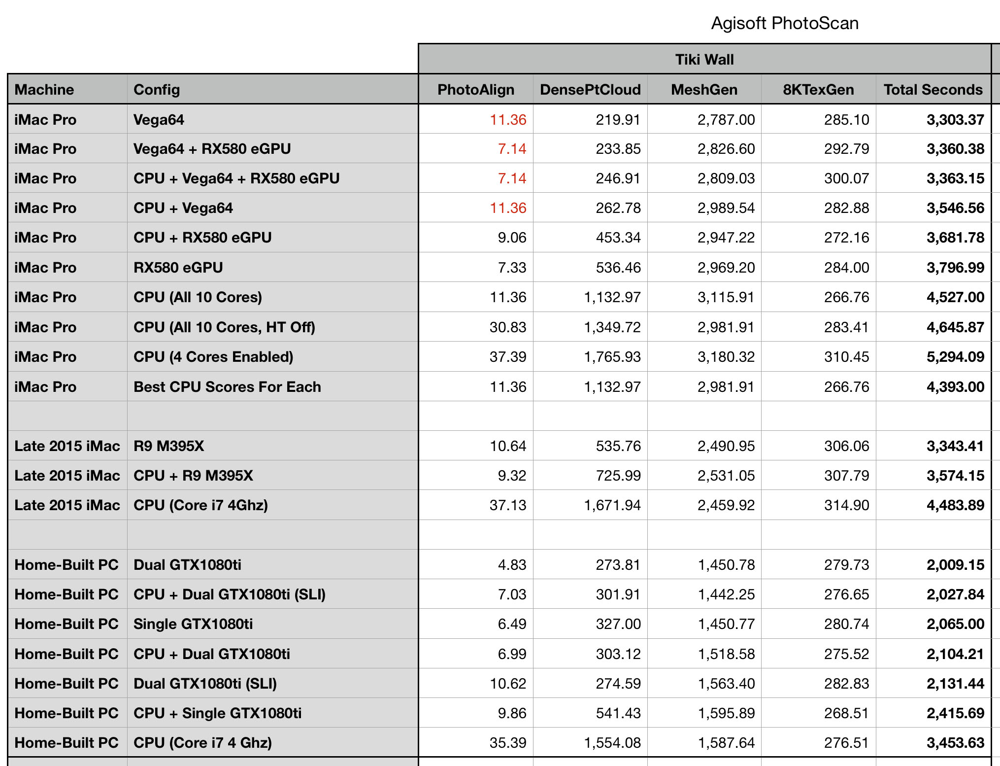

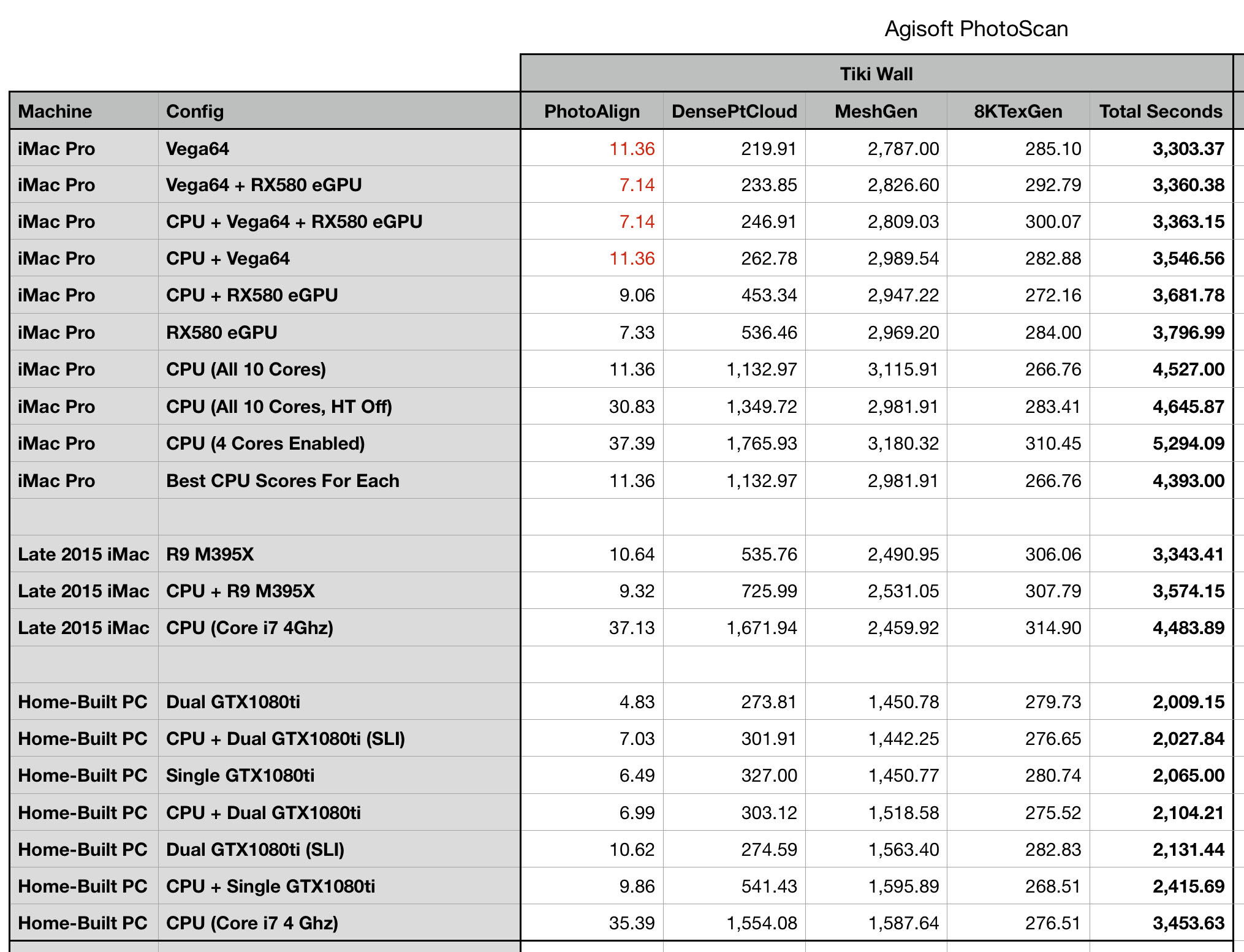

What makes you say that? I've tested software that ran faster on my 2015 iMac, my i7 PC, and where the iMP only barely beat a 2017 MBP due to the latter's thermal throttling.
My point was that it seems at first glance that the iMP seems pretty well balanced across the board more than the trash can. Of course there’s not much data out there for the 14&18 core units, but all indications are that their performance in lightly threaded apps will be much better than what we saw with the 12c Mac Pro which was pretty sluggish by comparison and the reason I liked it better as a 6c than when I “upgraded” to a 12c.
As to all the benchmarks that show the iMP getting beat by i7 based Macs, I think every one I see has been in a video app where QuickSync is part of the workflow. Honestly, my biggest frustration with the available reviews is that they are nearly all based in Video work. Of course since the ones doing them are YouTubers, that’s what they do. Virtually nothing out there to guide those of us that do very little video, dedicate our high thread count to more mundane things. My use of multiple cores is more driven by having large files open in apps like BlueBeam and AutoCAD, while having large windows VMs open handling Revit and lighting calculation modeling. None of these are particularly demanding by themselves except AGI lighting calculations, but together they can bring a system to its knees very well.

I did my tests on a 3D photogrammetry program (makes 3D models from photographs) and as you can see from my attached spreadsheet image, despite this being a computationally demanding program, it's optimized for 4 fast cores instead of higher numbers of slower ones.
Specifically, it seems as though it feeds data to every processor at once, and then waits until every processor is done before giving them all data again. Which means that computational outliers can force every other core to wait while they complete. Freezing utilization at 5% while they do so. But even when all the cores are working, utilization rarely goes above 50%. In this kind of program, an i7 will smoke it every time.
So buying more cores still requires trading off a performance hit when using most mass-market software, with the processing gains that you'll see when using expensive niche software. No, it's not as bad as the days when everything was single-threaded. But you're still limited by the optimizations developers use for the 99% of the market that the iMP doesn't represent.
Well, for that application, the "lesser"machine may be better, but to my point how bad was the 12C on the 2013 and before? I'm betting they were much worse. There will always be apps that find the weakness in a system, it's just a matter of what fits your workload best. Also why I cancelled my 10C order and got the base. For me, I don't think the Vega64, and extra cores would be worth the extra cash. The ram would be, but I can upgrade that later. Ive been working a 32GB footprint for a long time so no biggie there. I actually was close to getting the TOTL iMac5K fo many of the reasons you stated, but decided the extra TB3 ports, 10Gbe, Faster SSD, GPS and Proc were with the $1500 or so upgrade, but wouldn't scale as well to $3000 or so.
