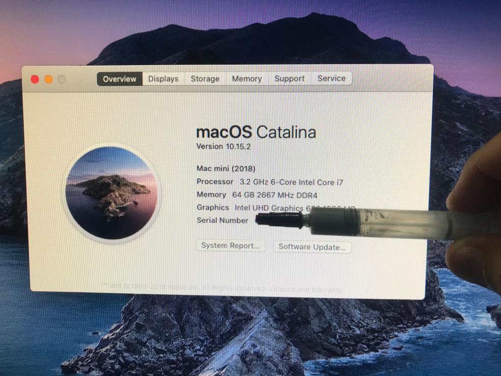

Go for 1 x 32gb. You can still can put in another 32gb for 64gb next time. The dual channel difference is negligible imo
