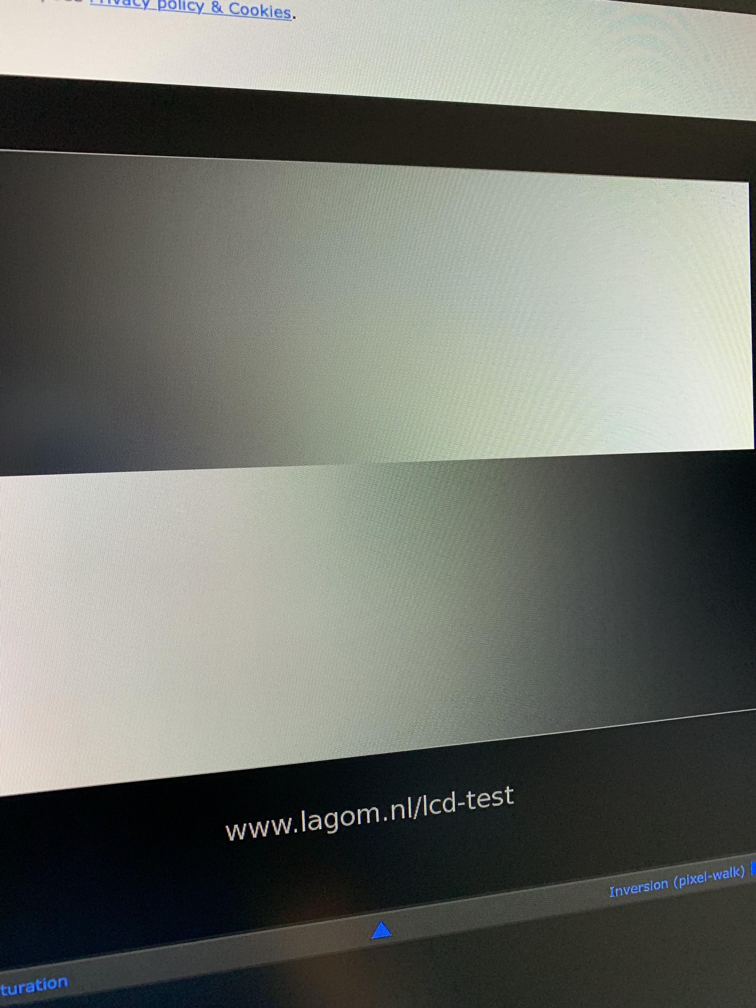

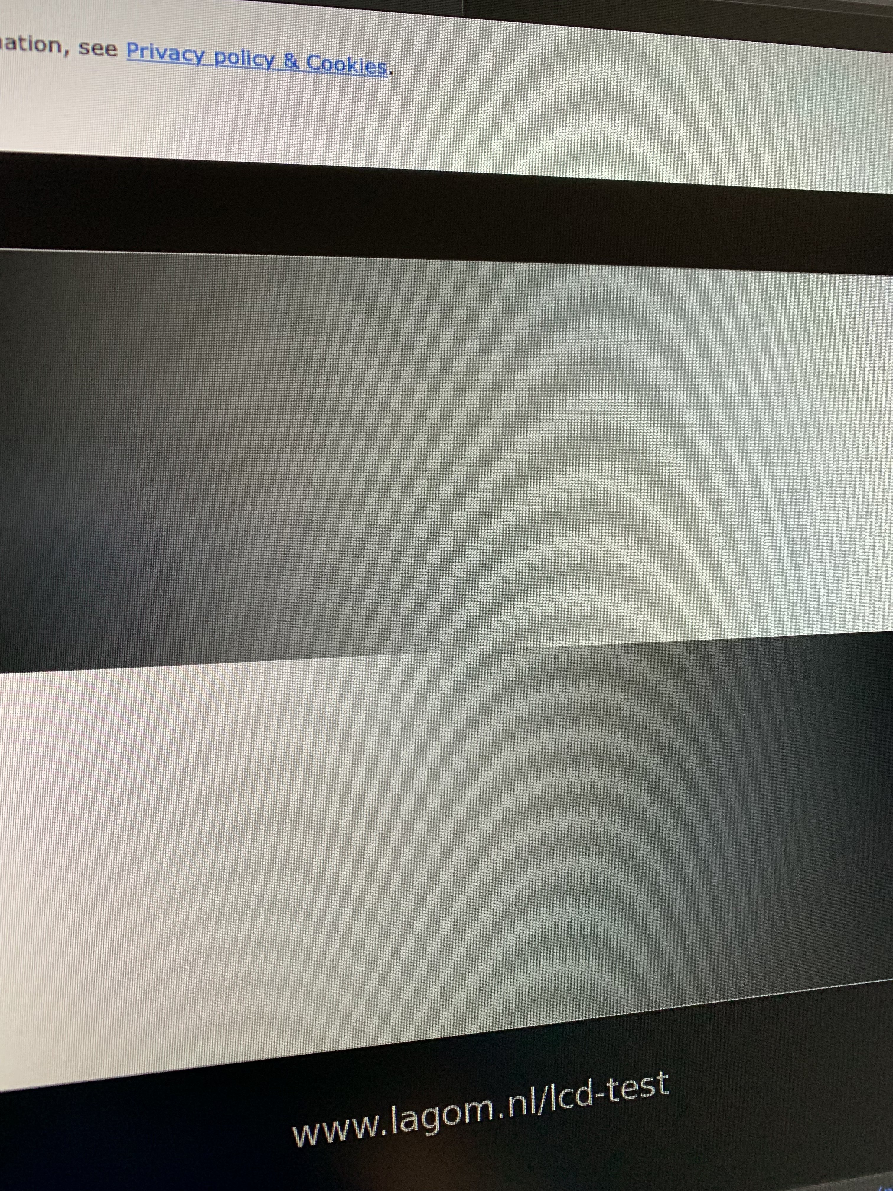

So I just tried a simple test of looking at test images to see banding and you can even see it there when using the DisplayPorts on the Vega 64. It is very subtle, but it is there.
