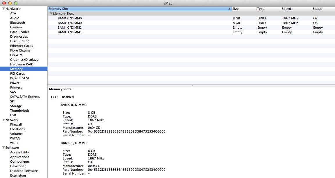

We have established elsewhere (after this thread was started) that 1866 ram does indeed run at 1866 in a 2012 iMac.
How are you certain of this?
Because if you install 16GB of 1600MHz CL10 ram alongside 1600MHz CL11 Apple ram, it shows it running at 1333MHz in the System Report.
1333MHz is the fastest speed the stock ram can run at CL10, so it drops the speed down to that rate. But the point is, it's all 1600MHz memory, but it shows the rate it's running at.
Got it. Thanks for the follow up.
