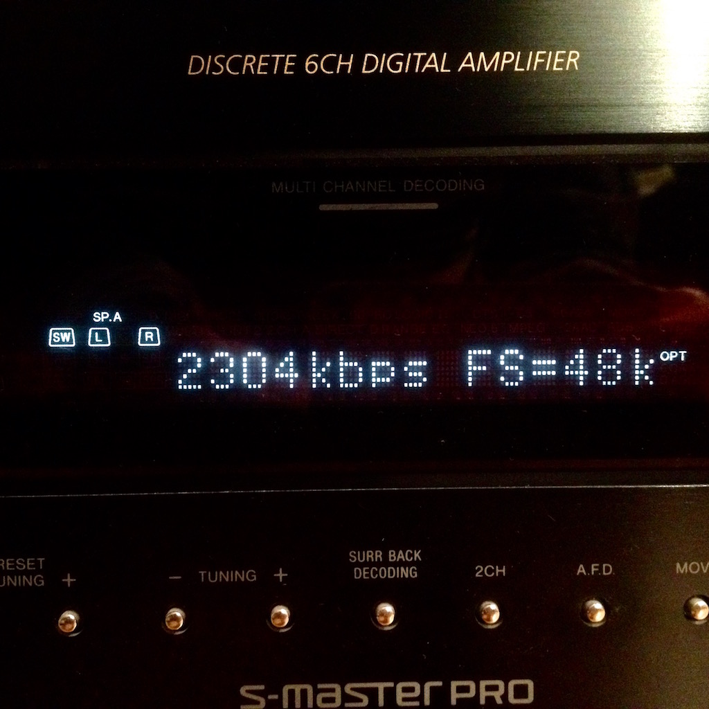

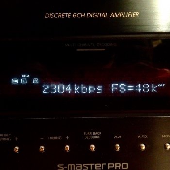

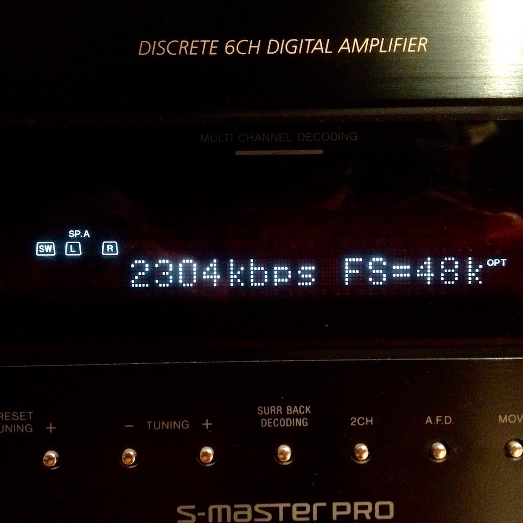

So, finally arrived at short testing. At the end of the day, do I need a HDMI connection from aTV to the amp?
Over the optical, I can only see 2304kbps at 48kHz, irrespective if I play a 320k MP3 or 24/192 ALAC.
