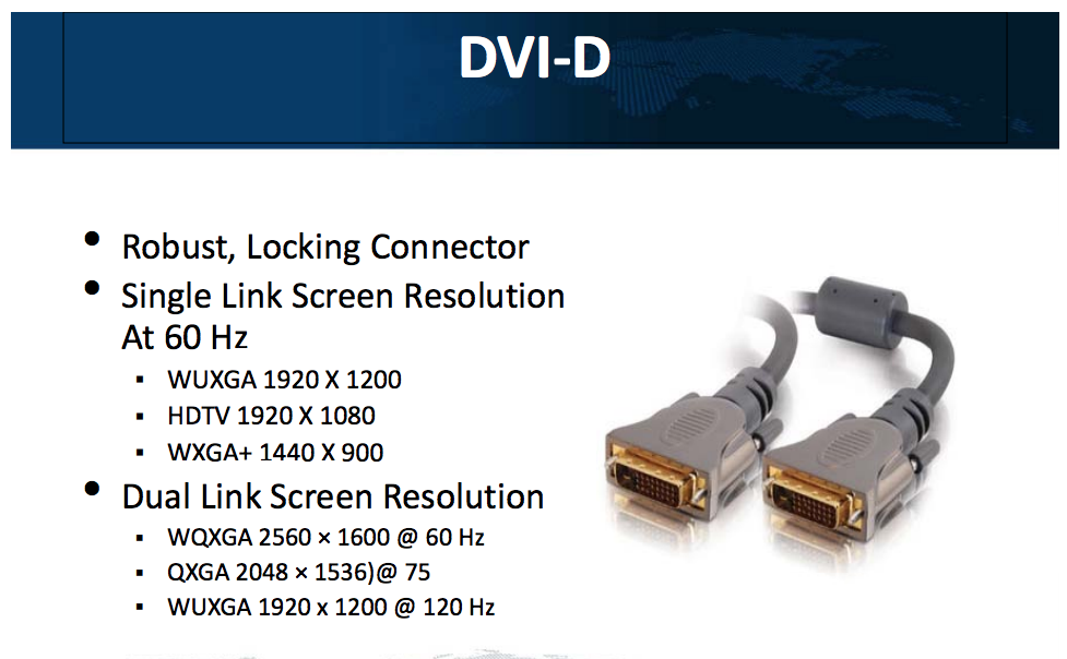

It's depend on the refresh rate, too. DVI-D can go upto 2k (2560x1440/1600). Many 2k monitors still feature DVI-D port.
The pixel clock is the limiting factor.
Single-link DVI can go up to 165 MHz pixel clock, making e.g. the following modes possible (using CVT-RB timings; pixel clock in parentheses):
  • 1920×1080 at 60 Hz (138.5 MHz; although I've also seen 148.5 MHz modes)
  • 1920×1200 at 60 Hz (154 MHz)
  • 2048×1152 at 60 Hz (156.75 MHz)
  • 2560×1440 at 41 Hz (163.5 MHz)
  • 2560×1600 at 37 Hz (163.75 MHz)
  • 3840×2160 at 18 Hz (156.75 MHz)
  • 3840×2400 at 17 Hz (164.25 MHz)
Dual-link DVI can officially go up to 330 MHz pixel clock (modern GPUs may go even higher), allowing for e.g. (when using CVT-RB timings):
  • 2560×1440 at 60 Hz (241.5 MHz)
  • 2560×1600 at 60 Hz (268.5 MHz)
  • 3840×2160 at 37 Hz (325.25 MHz)
  • 3840×2400 at 33 Hz (321.5 MHz)

Thanks, this is good to know about DVI.
That said, I’m guessing I use the USB-C to DP cables instead, if I plan on moving up to a 4K display in the future.
