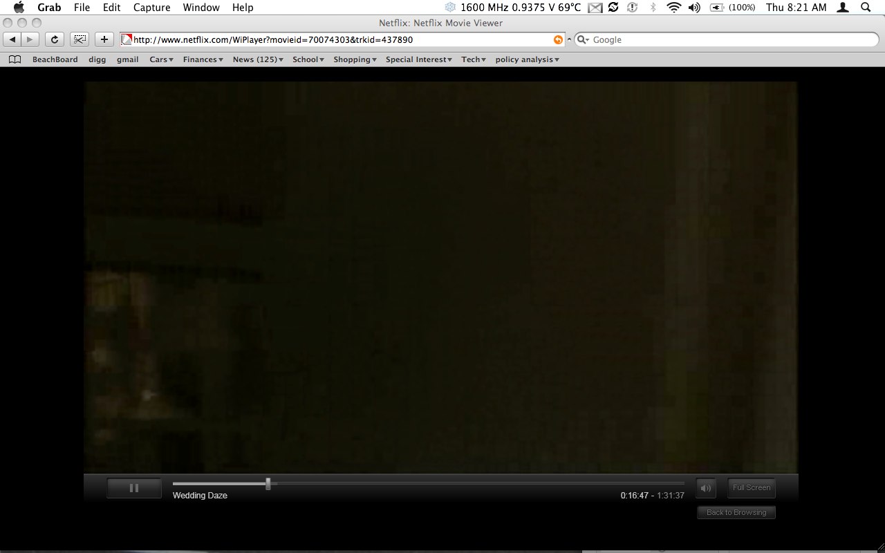

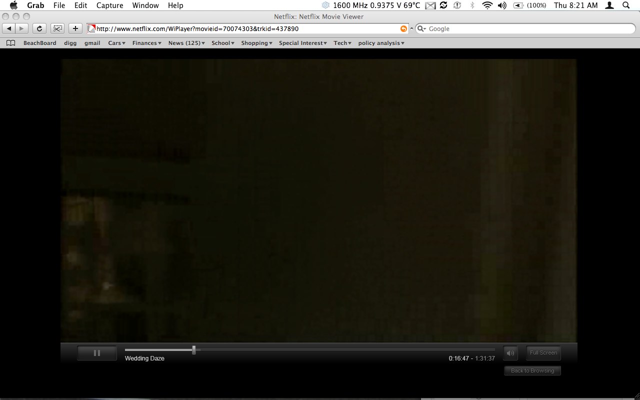

Celcius. Using coolbook that cured my core from shutting down, however, I can't really remember what my temps were like before the update. I did watch a full 21 minute episode on hulu and the average temp was around 68 celius. I've watched netflix streamed movies and the temps usually go around 81. I'll test today and see.
OMG! 😱
Watching netflix streamed, by average temps are 68-70 degrees celcius w/coolbook and the new quicktime/ichat update.
Before it used to be 80 degrees celcius!😀
Attached is the screen shot!!!

This update is amazing
