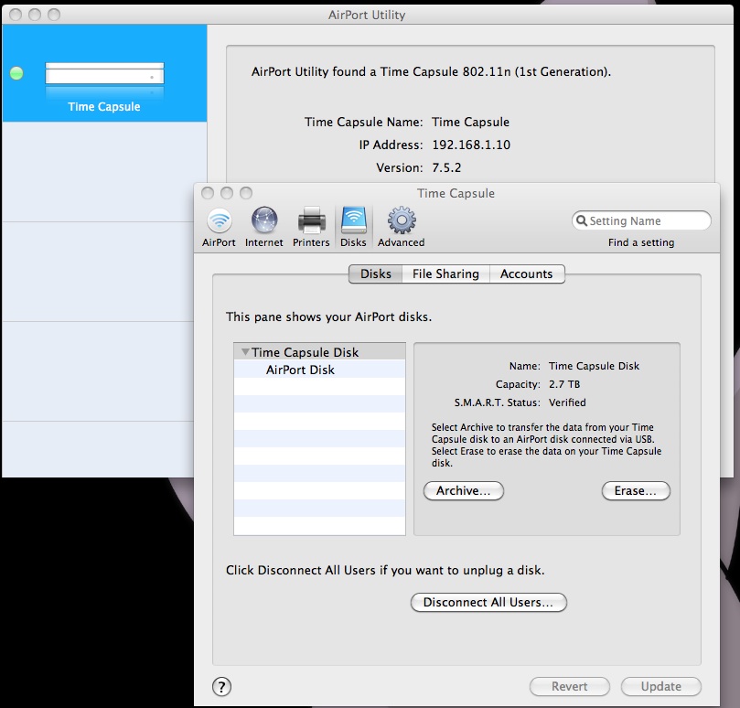

Holy crap, it *CAN* be done. Picked up a 3TB Western Digital "MyBook Essential" external HD on sale at Fry's ($129), popped out the drive and installed it in my 1st gen Time Capsule. I bought this thing on release day, and it surprisingly still works fine.
Powered up the TC and told it to erase the disk. It's backing up now. 😀
