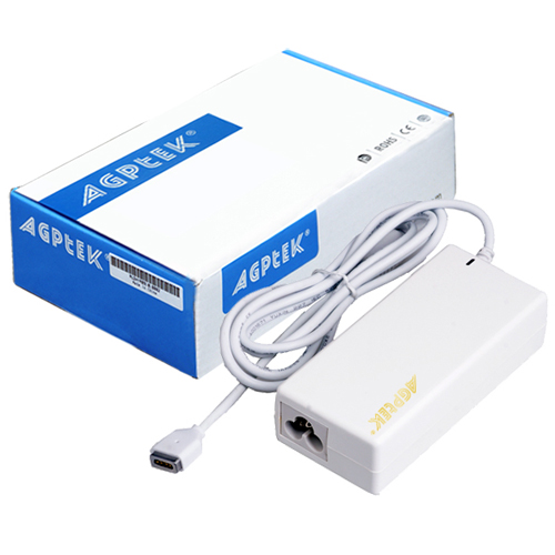

Has anyone got any other recomendations for spare chargers other than the genuine apple ones?
I take it back. Received mine yesterday, was very excited.
Unfortunately, it won't charge my 11.6" Air. I get the plug icon in the battery, but it says, "Not charging."
A quick glance at System Profiler shows the following:

Needless to say, I was disappointed. I contacted the seller, who agreed to refund me via PayPal.
Notice the AC Charger information... Who knew that there was actual communication instead of just sending power? I hope Apple isn't blacklisting bad family or serial number IDs, or we could be screwed with only buying Apple-certified adapters.
