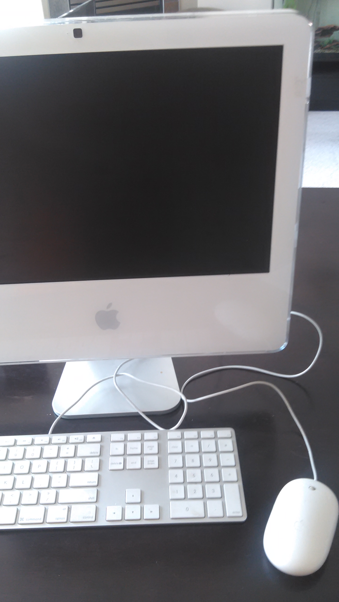

I will try booting from the install DVD 1. I have also included a pic of the computer, keyboard and mouse. So ya'll know what I am using.

The "green light" only applies to the Wireless Keyboard which you are not using. So the Caps lock doesn't apply either here.

That keyboard is newer than the iMac. A 2006 iMac would have come with a white plastic keyboard.

Again, the green light when pressing the caps lock button doesn't tell you much more than you have power to the keyboard (the USB bus has power)
You should try a different keyboard. Although some PC keyboards may also tend to ignore the boot commands, most will work when you discover which keys to press. The main difference will be that the command and alt/option keys are reversed.
