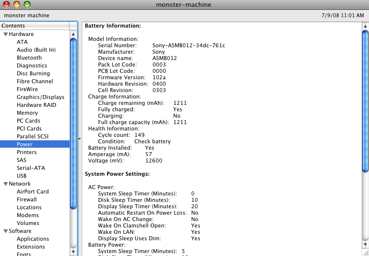

I have a 1st revision Macbook Pro 15" that's about 2 years and a few months old, and all of a sudden the battery will not provide power past approximately 76%. As soon as the the battery displays, 75% or 76% of the charge remaining, the laptop shuts off completely, does not warn me that my battery is low, and does not sleep or save the contents of my RAM - nothing it should be doing. The battery is only at 149 cycles as of today, and I don't have any sort of AppleCare plan. Is this something I can get replaced under a warranty, or would I have to shell out for a new battery? And is it even worth it?

When was the last time you calibrated your battery? Calibrate your battery first and if that still doesnt work call Apple. You clearly have a defective battery because you only have 149 cycles and your capacity is less than 80%. Calibrate your battery and if doesnt work...call Apple or go to the Apple Store.
Notice the Condition is: Check battery.

Notice the extreme differences in yours and mine. Ther should not be that much of a difference.
After a few years, Lithium cells will die without user intervention so this drop and sudden loss in capacity is expected.

I figured there shouldn't be that much of a loss either, but I guess it's expected as alphapod described. Thank you for your replies everyone, off to buy a new battery I suppose.
Although Lith. batteries are expected to have a drop in performance, it shouldn't be this much of a drop.
Revision A MBP's had very bad batteries. I had one too but instead of dying at 76% it died at 57%. Only way to go is replacing it. At least yours didnt expand.
