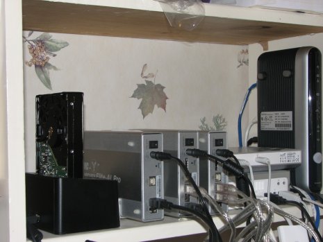

I use 1-2TB hard drives, clone them and store "off site".
Home server (6TB, toaster used to clone, 1TB external backs up mini):
