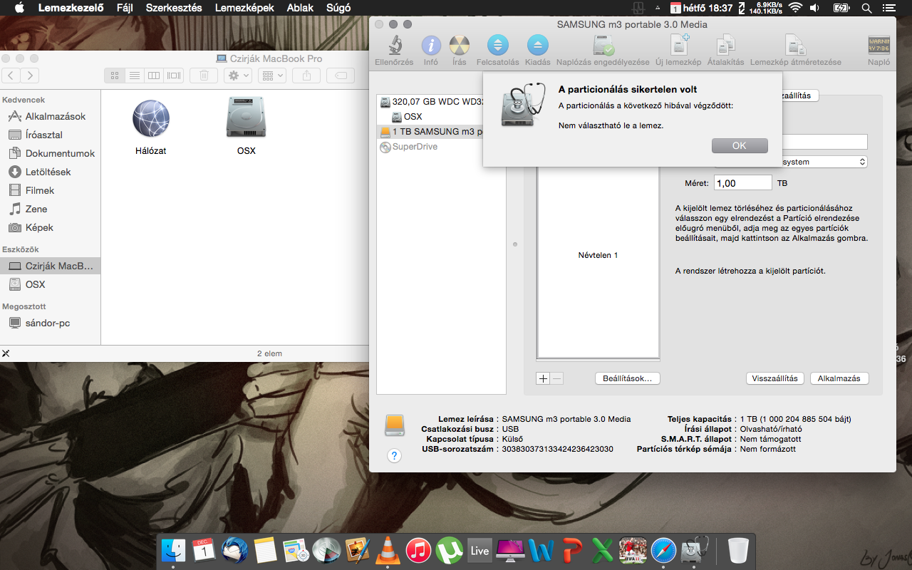

Thanks but it's not visible on the desktop. It doesn't have partitions or anything.
Here, in disk utility it appears, but nowhere else. I will look into that parted magic solution too, thanks! 🙂
