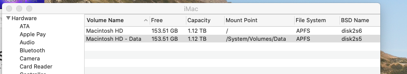

Why is my 1TB fusion drive only showing 150Meg free when I have only installed about 80G of apps? Some stuff is downloading from Onedrive but all the same not even 10% of that volume of data.

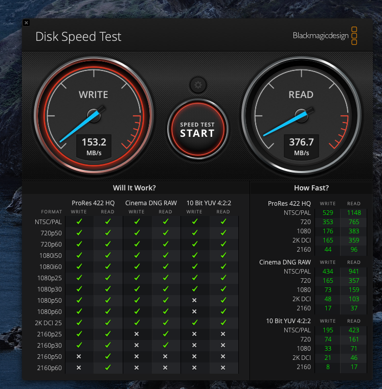

Ok, after leaving machine for a few hours the speeds seem to be much better. Maybe indexing and stuff was going on in the background after the reinstall.
Apps do seem to be bouncing a *lot* though upon opening them, takes a minute to load Lightroom Classic for instance. I will give it a couple of days to see if the machine settles down.
This could be normal behavior for a Fusion Drive, especially after a clean install, and will get better the more you use your machine.

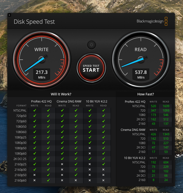

Ok, looking much better 24 hours after the fresh reinstall of Catalina. So clearly after the install, OSX is doing something pretty fundamental stuff to the disks still for multiple hours.

TBH, at those speeds on a late-2013 i5 with the 1TB fusion I am pretty happy and I am starting to question if it is worth the risk opening the machine up and spending $150+ on a new NVMe to improve to a max of 740/740 that the 2013 maxes out at.
I have a broken hinge so I may still do it. I am latest 480 boot as well so I'm all good to go should I choose to do it.
