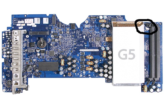

Well I'm not too good at this stuff and I don't really know what to look at and see what's normal and what's not inside the machine but when unscrewing some screws around the hard drive one of the wires disconnected from one of the boards, so now there is some random cable on my hard drive and I have no clue what it's supposed to plug into. I'm having trouble finding videos or pics/instructions of iMac G5 17" als disassembly instructions.
Edit: Nevermind I see they're on the apple website.
http://manuals.info.apple.com/en_US/imacG5_17inch_harddrive.pdf
It says (pg 8) "leave the cables attached to your logic board" one of them disconnected and I can't find where to plug it back in, is it possible to get plugged back in easily?
Lay it screen-down on a table. There are three screws on the bottom with the RAM door, unscrew and the back panel lifts off.
Yeah I knew that but I didn't know how to specifically get the HDD out safely, but I did anyways and a cable got disconnected from the logic board, but its still attached to the HDD. I have no clue where to plug it back in. I made a little video showing which cable exactly and I'll upload it to youtube now.
I have Seagate, WD Green and Samsung F1's in my Mac Pro, the 1TB F1's are much much cooler than the other two drives. If you need a cooler running drive, I'd opt for a Samsung.
Take out both RAM modules and see the connector circled below.
The plug will only fit in one way.
