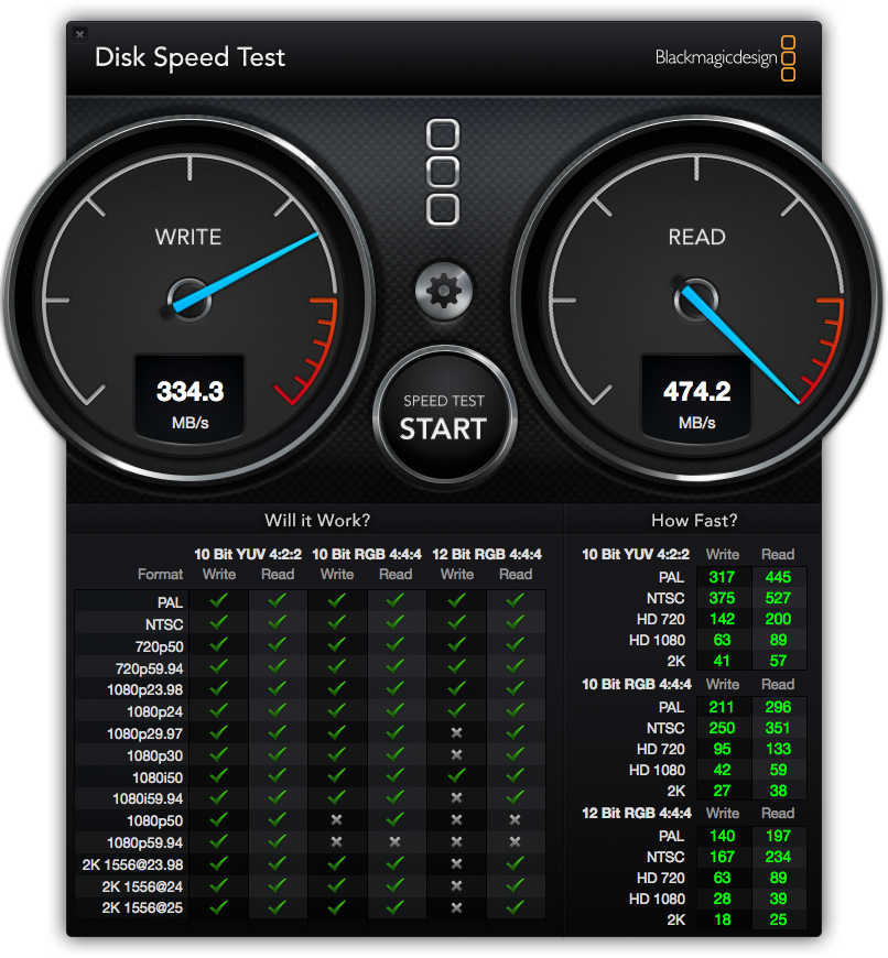

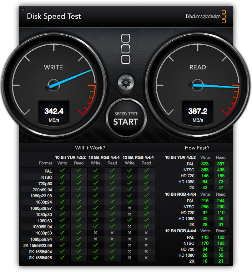

FWIW: I finally found a bus-powered Thunderbolt enclosure which seems to be reliable with a Crucial M500 960GB SSD. It is the Oyen Digital "Mini Pro Thunderbolt SSD" which I picked up on a recent sale with a 128GB SSD, which I swapped with the Crucial 980GB SSD. All other enclosures that I have tried with it were flakey from the start. This one seemed to operate properly from the start, and I just did a bit of a stress test using CCC to copy my OS X environment and then copying my Aperture 400GB library from a LaCie Rugged 500GB SSD to the Oyen/Crucial M500 using the iMac. It maintained a 350-410MB/Sec transfer rate for about the 1/2 hour each that it took to do the transfers. The finned aluminum case did get slightly warm, but not overly so.
Unfortunately this Oyen drive is not available as a bare enclosure at this time.
Here are some DiskSpeedTest results for the two drives:
Oyen/Crucial M500 960GB SSD ----------------- LaCie Rugged Samsung 840 EVO 500 GB SSD
