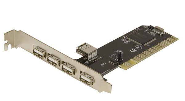

The picture shows VIA chip but the seller's description says NEC chip. I don't know what is the chip in your card.
VIA can work. I had one but if I remember it right, it needs a driver to work with OS X (OS 9 is not supported). It's not available on VIA's web site anymore but I have it backed up on a DVD and I think you can try downloading it from http://support.dynamode.com/test/drivers/controllers/usb-4pci-2.0/ (VIAMACUSB_160_G4_p1.pkg.zip).
The ones with NEC chip are more compatible/reliable with Mac, real plug & play for Mac.
PS. From http://gmb.nl/item.aspx?id=1852
The OP's card uses a VIA chip.

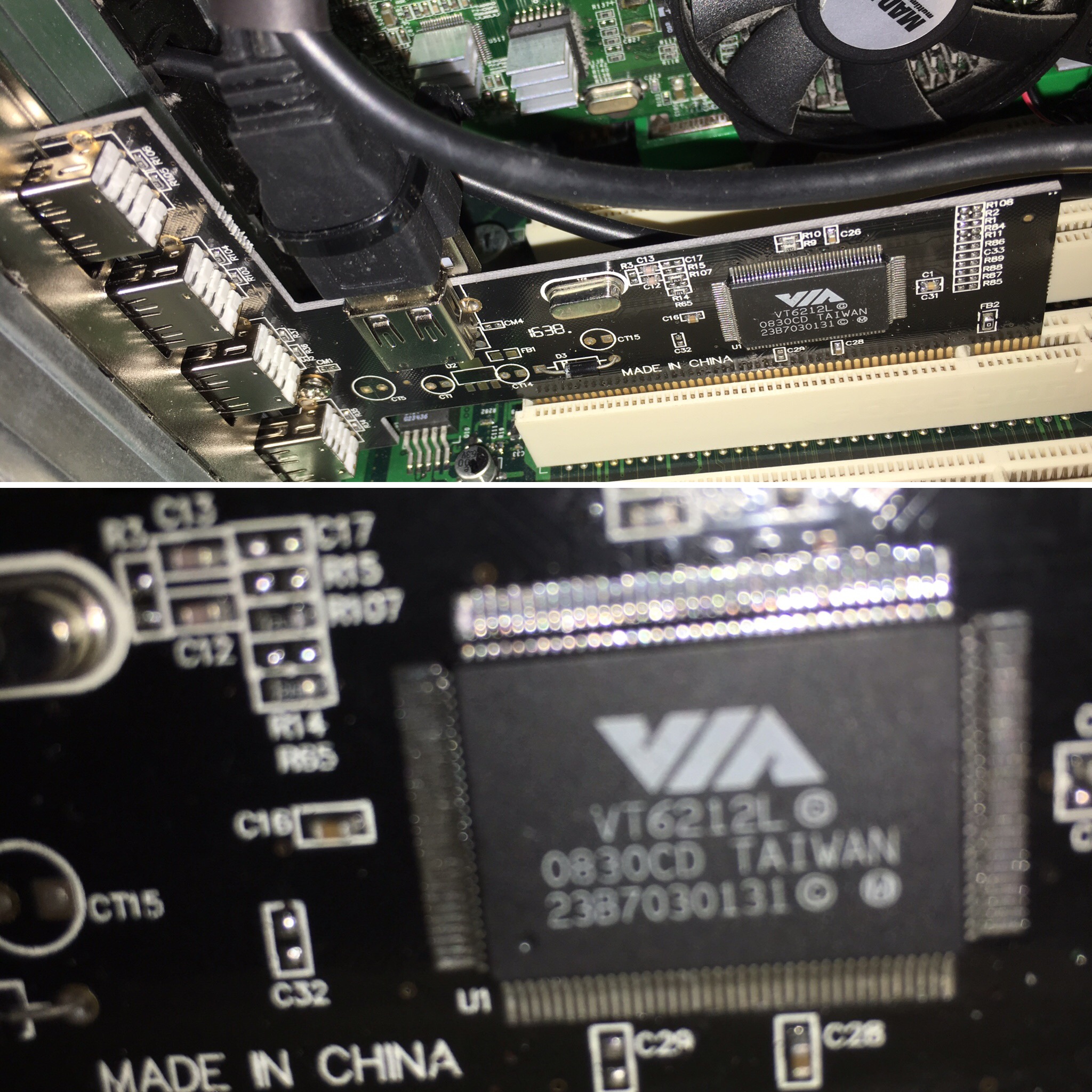

This is not a NEC card. It is indeed the VIA chipset. Attached photo is the card in my QS Powermac. Running 10.5.8, this card was plug & play for me - no issues at all, no driver installation. Whatever the usb2.0 PCI card required, it was already present within leopard. I cannot verify the seller claims of earlier OSX version support as this went straight into a leopard box. I have not tried it on earlier OSX releases or classic OS.

Out of curiosity, I installed my VIA (VT6212L) card along side the NEC (D720101F1) card. Both worked under 10.5.8 like you said. Tried booting 10.4.11, the Mac turned itself off during start-up...
No, I was not panic, quite used to it. Switched the video card from Radeon 9800 Pro to GeForce 4MX, then it booted but still crashed on start-up. Tried turning it on again, then it booted fine, was going to check how the VIA card was presented in System Profiler but the Mac went into sleep mode by itself and would not wake up...

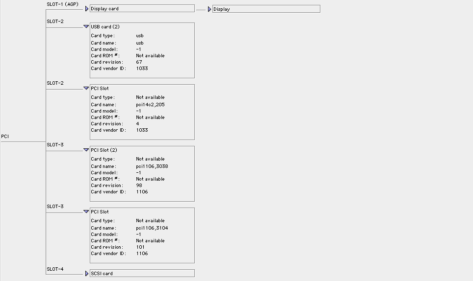

Fine, tried it again, this time I could look into the System Profiler and the VIA card was recognized correctly and the ports worked, without installing any driver. I don't remember why I needed to install the driver. May be at the time I was using an earlier version of Tiger that needed the driver, I don't know.
Then I tried booting into OS 9, real OS 9 (not the Classic). Both cards showed up in OS 9's System Profiler. The NEC was in slot-2, the VIA was in slot-3. But only the NEC was recognized as USB. Sure enough, the only card that worked was the NEC one, at USB 1.1 speed.
The reason I stopped using the VIA card was reliability. It seemed not to get along with the Radeon 9800 Pro and also had increasing intermittent issues. But I suspect the real culprit is my 15 years old MDD itself and the NEC card may be just "more forgiving" than the VIA card. The number of electrolytic capacitors on the two cards is quite different: the NEC has three 22uF 25V's and five 47uF 16V's while the VIA has only two 22uF 16V's. Not sure if that's enough to cause that difference.
By the way, I see currently available cards on eBay have a different layout from mine. So the NEC chip may not be a guarantee that it will work with a Mac anymore. http://macos9lives.com/smforum/index.php?topic=3332.0

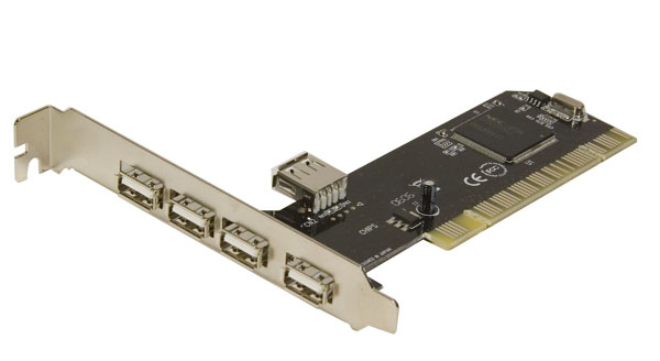

Okay i'll start from the beginning..imagine a 4 port pci card in the G4syba-sd-v2-5u-5-port-4-1-usb-2-0-pci-card-nec-chip-6.jpg
When i have 1 drive plugged in i get 35MB/sec doing file transfers/benchmarks.
Adding a 2nd drive to the port and speed gets reduced to 25MB/sec
Adding a 3rd drive the speeds drops to 16MB/sec
Adding a 4th drive makes file transfers crawl at 10.5MB/sec
On any drive i test thats on the card.
To me it seems like its sharing total bandwidth and dividing it between each port.
When i unplug 3 drives i get the full speed of the card once again.
Very Strange.
Okay i'll start from the beginning..imagine a 4 port pci card in the G4View attachment 851971
Very Strange.
