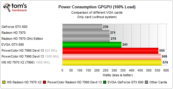

yeah, about that 375watts...
Under the load of a compute-heavy task, the HIS and PowerColor cards suck down power as if it were going out of style. These aren't total system power numbers, mind you. Both of those Radeon HD 7990-class cards are consuming 570 W on their own. Does your apartment lack a heater? Well, winter is coming, and either one of those boards will keep your room warm when it's cool outside.
So I guess as long as you're not using them for, you know, compute-heavy tasks ...
Those Devil 13 cards are not reference AMD designs. Apparently they are three slot monsters that consume massive amounts of power (as evidenced by your chart) and were actually released prior to AMDs reference design (without the benefit of binning). They are not representative of a normal AMD 7990. I'm not sure about the HIS, although it would appear to suffer from the same issue.
