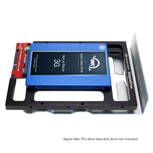

I need a 2.5" drive adapter so I can mount a 2.5" SATA SSD on one of my cMP drive trays/sleds.
Newertech/OWC has one such adapter (the AdaptaDrive):
... but since I have to order this from abroad, with the taxes, shipping etc. it'll become very expensive, so I was wondering if there are any "off the shelf" type similar adapters for your average PC or whatever, or if the one from OWC has specific dimensions for the cMP, and this is what I must get?

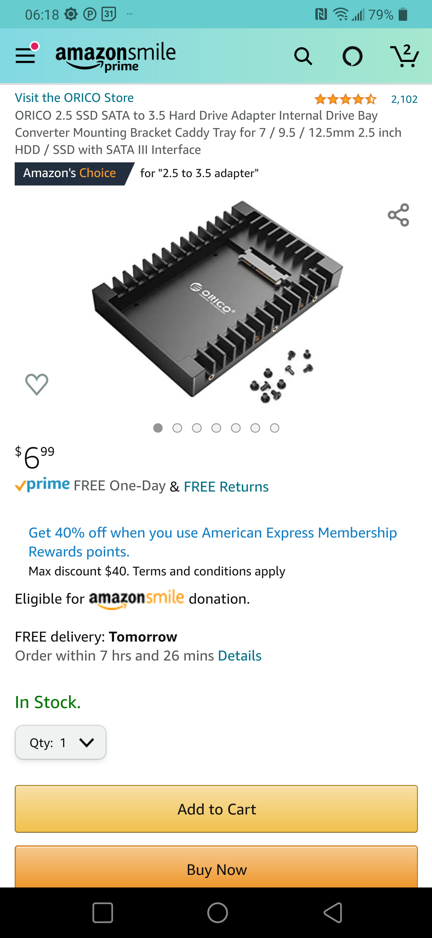

You don't need anything fancy or expensive. 3.5"/2.5" SATA adapters are really (relatively) cheap.
There are hundreds of them on eBay and Amazon for less than $10.
I like Icydock, and use this one:
You can find them on eBay in the multipacks for about $10 each.
If that is too much, there are cheaper options for you.

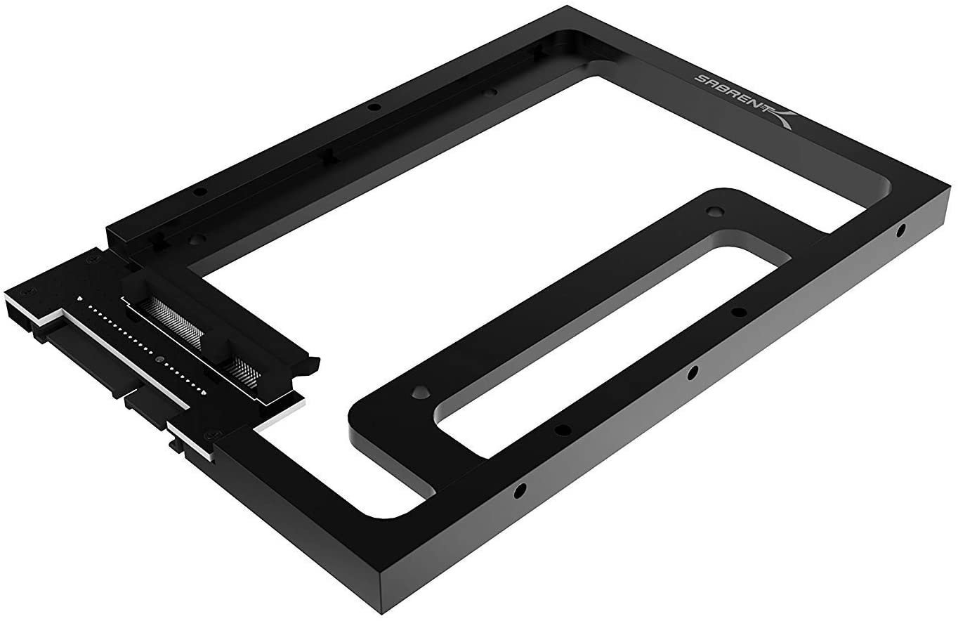

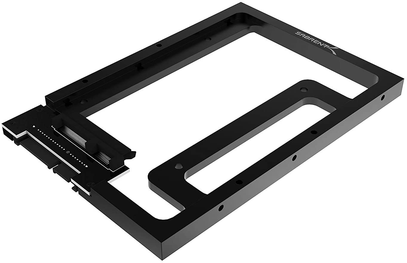

I've used several of these in my 5,1. Works fine and might be easier/cheaper for you to obtain?
Sabrent 2.5” SSD & SATA Hard Drive to Desktop 3.5” SATA Bay Converter Mounting Kit (BK-PCBS)
Reactions: permanentmacdabbler
I second this and it's usually cheap. I do have one of these mentioned previously:
It's a lot better quality light weight and slots in and out more smoothly and directly to the SATA port (I do worry about the additional SATA to SATA connection on others and the angle looks a tiny mm off on my Sabrent) but the Sabrent posted above was much more cost effective especially long term as it is compatible with other devices so can still be used if (when) the Mac Pro kicks the bucket.
+1 for the OWC mount pro.
Personally I'm far from a OWC fan, but this is a very well made product with a nice appearance.
The main reason for me to choose this one is, as mentioned by @permanentmacdabbler too, that the SSD is connected directly to the SATA port and not through another connector.
One thing i noticed though: it seems that the OWC drive sled is a fraction of a millimeter too long or so (or it's the blue paint in the cutout where the door mechanism slides), because closing the side door I notice a little more resistance with 1 or more of these sleds inserted...

Apparently getting a decently priced adapter (i.e. EUR 10-20/US$ 12-24) looks to be easier said than done here in Norway! And the ones i've found seem to be made for mounting the adapter to the sides of a 3.5" bay, not from underneath as with the Mac Pro sleds.
Strangely a few regular (non-Mac specific) local dealers sell the OWC "AdapaDrive" adapter, but regardless where I buy from (including OWC Europe) the end cost will be around EUR 40/US$ 48 (the 2.5" OWC sled from Matrix audio or directly from OWC Europe being a little cheaper) regardless of where I buy them from. I'll probably just have to bite the bullet, but try to order it together with other needed items to cut shipping/duty costs down.
You guys have a point with the OWC 2.5" sled connecting the drive directly to the Mac Pro backplane. On the other hand the AdaptaDrive adapter I've already got has worked flawlessly for years, and it's not something you plug in and out all the time, but definitely something to consider (though I have the same "not quite a perfect fit" experience as KeesMacPro points out, with my OWC 3.5" replacement sleds).

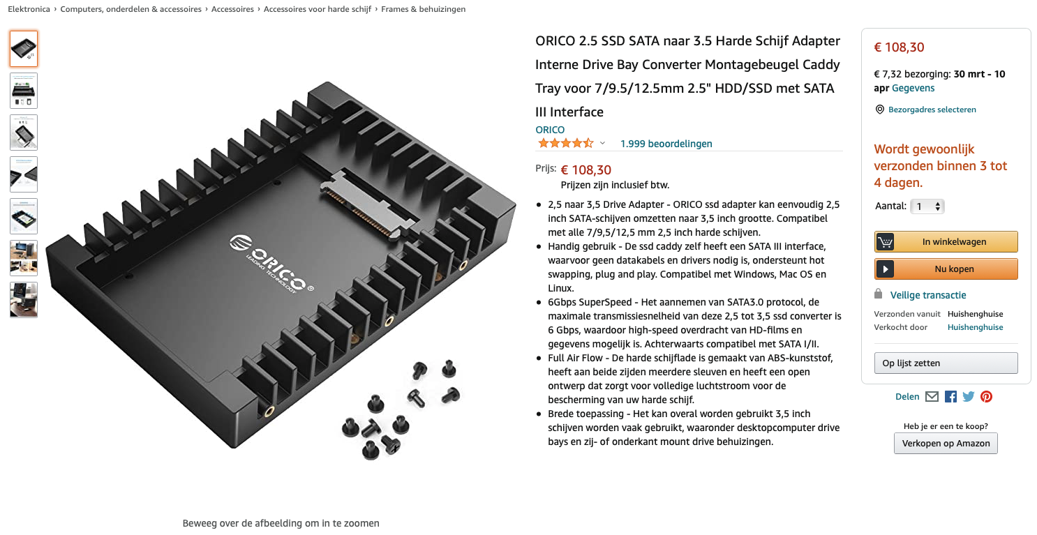

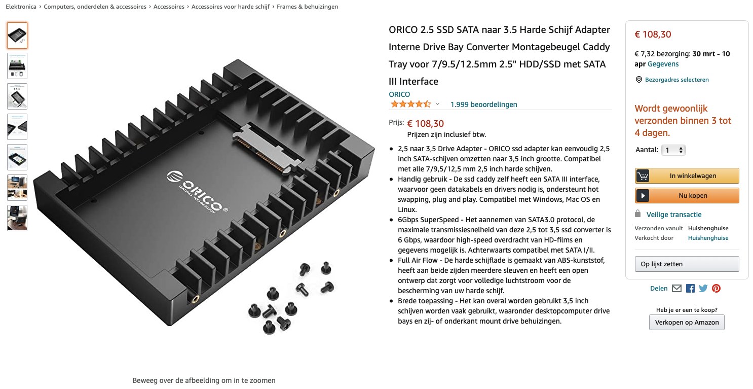

I've used this in a few MP sleds without issue:
Looks good but.... not quite sure €108,30 is worth it....
Ah , that's with taxes included... 🤣 🤣 🤣

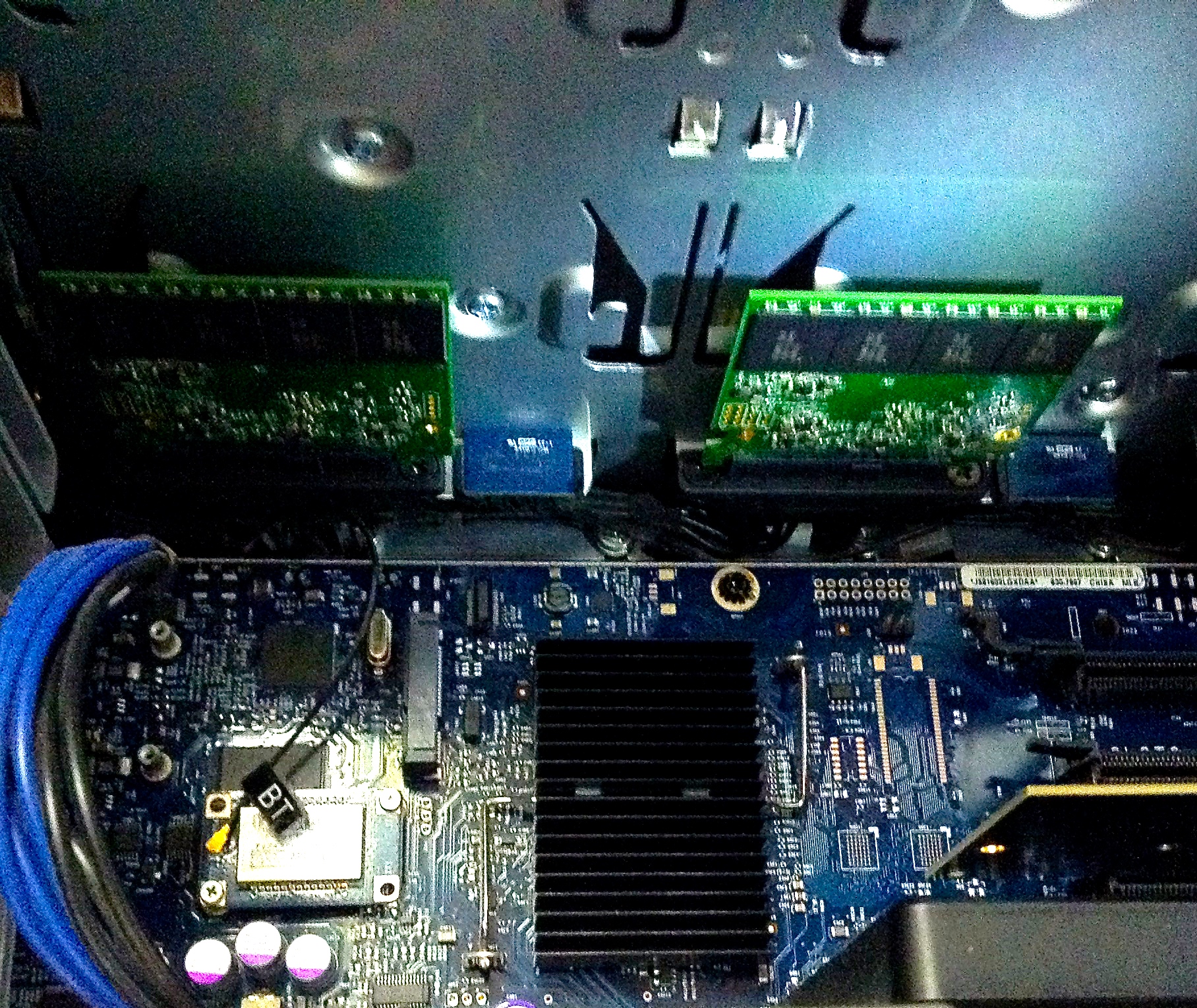

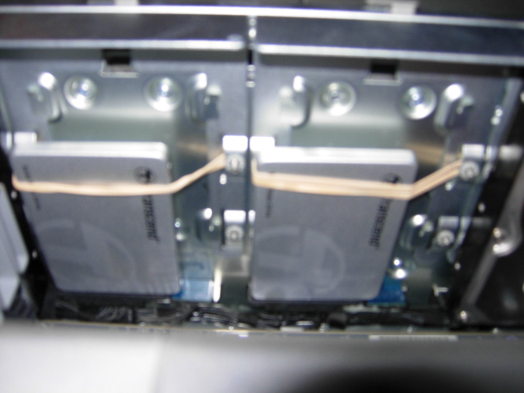

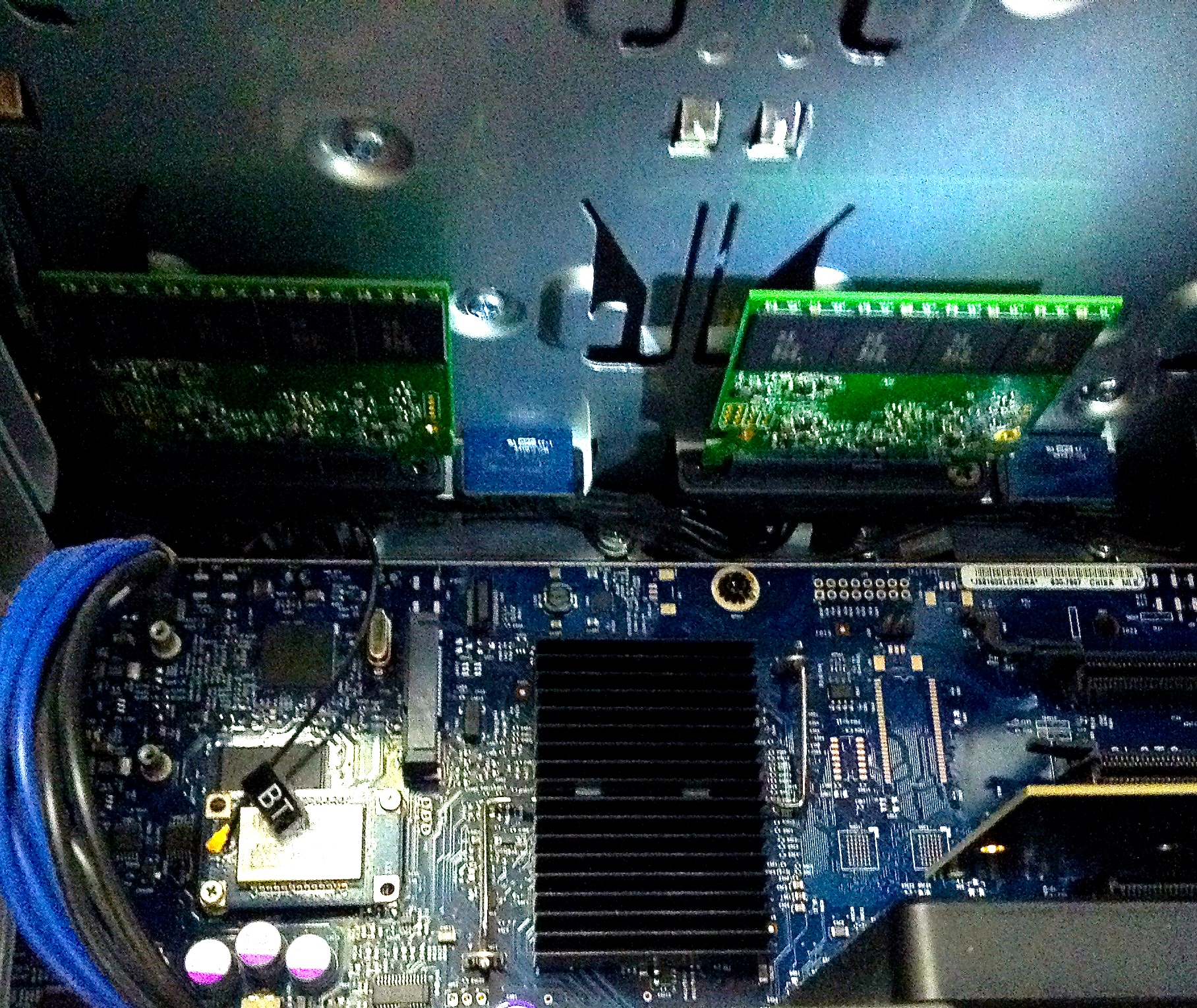

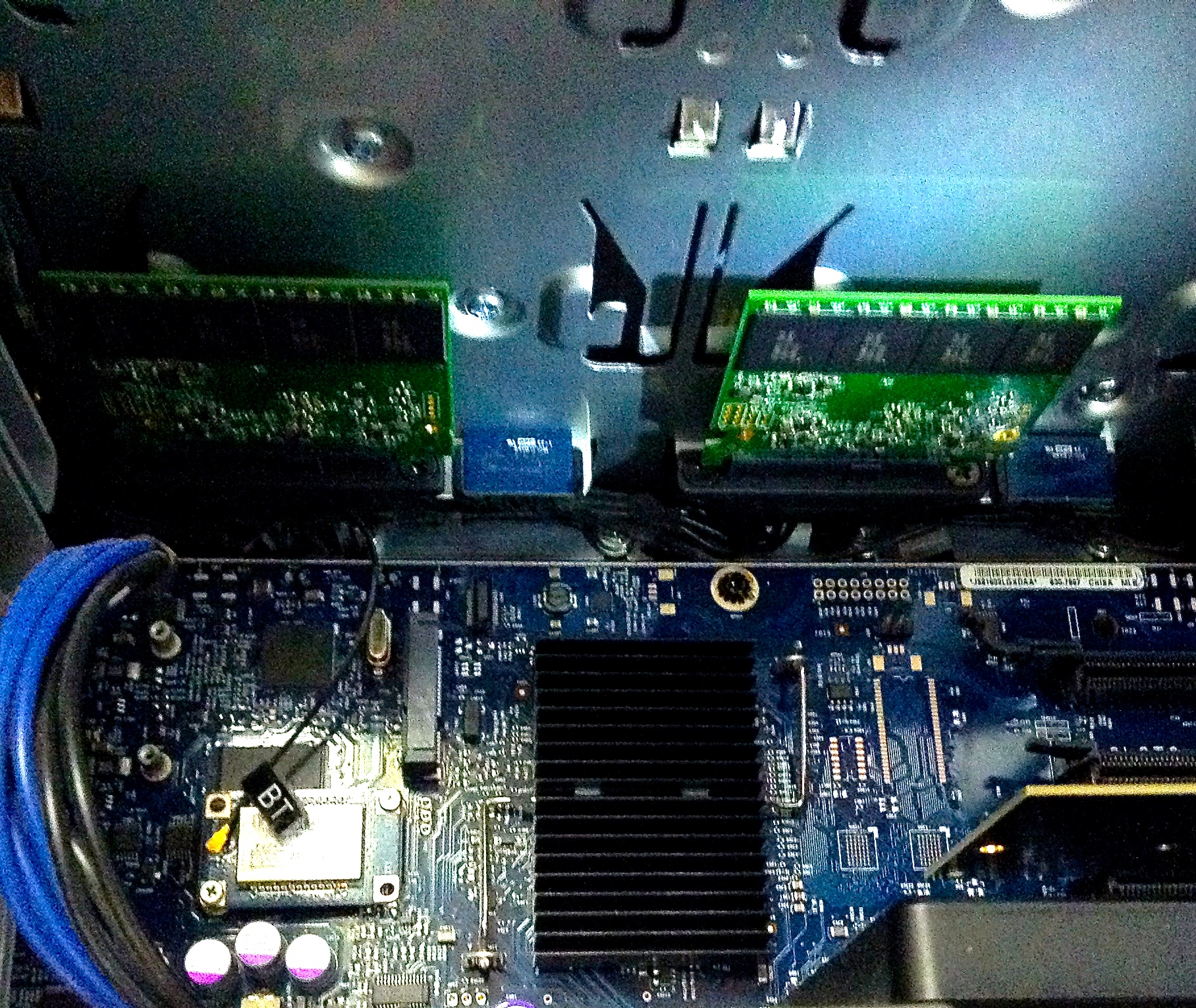

I stopped using adapters along time ago.
I just remove the little circuit board from the SSD case and plug it in directly.
Been running like this for several years now without any issues whatsoever.
You can do the same thing without removing the case, too.
It would be interesting to compare SSD Temp (is there a sensor?) with and without case. I always thought the case served as a heatsink...
Been there and done that. 🙂
But I wouldn't try it without some means of support.
The added weight of some cases might play hell with the sata sockets.
