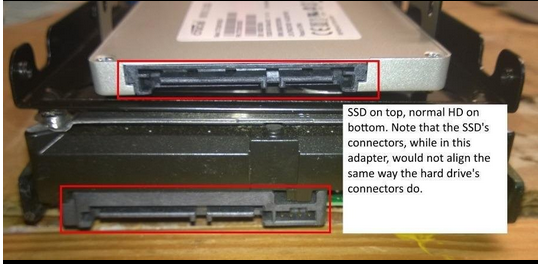

i cant seem to find any bracket that makes a 2.5 properly aligned like a 3.5 hard drive. I have a icy dock that does this but the sata connector on the inside to one that would connect to the mac pro sled would cause freezes and lag so im looking to skip the middle man and just try to find a bracket. I know the mount pro from owc does this but i don't want an entirely new sled.
Ive attached a picture down below to a problem that im having with adapter not aligning correctly.
Maybe someone who deals with hot swappable servers that use the bottom of the 3.5 hard drive screws can provide some input.

I have two of those. They are very good but I wish they were cMP aluminium.
If you are talking about 2.5" SSD, just put that in the optical bay without any mount is the easiest and cheapest option (I am doing that right now).
Or you can just plug it into any of the bay. Since the SSD is so light, the SATA port is strong enough to support the SSD at there. Quite a few of my friends doing that, no one even has any issue. However, I personally will recommend you at least tape it to the case (again, another cheap, dirty, but practical solution). Just a little piece of strong tape will hang the SSD at there forever.

A heat-sink mount from a Raptor drive would do it, they're probably quite cheap on eBay these days.

I have 3 SSDs in my 2010 Mac Pro. They are in bays 2-4. I found 80GB WD Velociraptors on eBay for $8.00 each so l purchased 3 of them. I removed the 80 GB HDDs and mounted my SSDs using the WD mount and installed them on the stock Apple HDD sleds. They work perfectly and are definitely the cheapest solution you can find.

WD Velociraptors don't seem to be SSDs, looks like they are 10K RPM fast HDDs? Also looks like a 2½" HDD installed in a large heatsink with the outputs in the same spot as a 3½" HDD. Am I missing something?

Nope, remove the 2.5" 10k spinner and replace it with an SSD. You now have a giant heatsink/adapter,that lets you mount your SSD in an SATA drive bay using the stock sled (very cheaply), and with an incredible heatsink.
