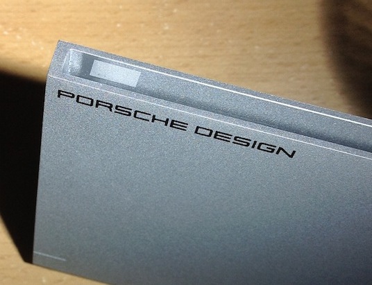

But here's a new Lacie P9223 Slim, which is their recent product! :eek:

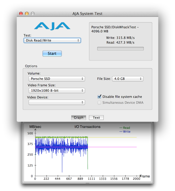

11mm thick unibody enclosure with slide-in plastic frame that holds a 7mm drive. P9223 comes with either 500GB single-platter Seagate 5400rpm HDD or 120GB SSD. The latter is rated at 400MB/s, which means ASMedia SATA 6G controller lives inside. Moreover, it turned out that HDD version uses the same controller and.... boy it's fast!

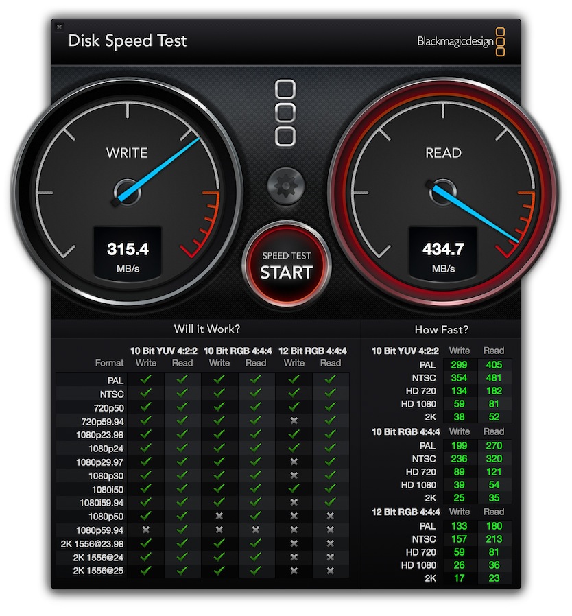

All tests are done with the Samsung 840 (500GB 2.5" SSD) inside. I didn't bother to run benchmarks with stock HDD and replaced the drive immediately :D
Blackmagic Disk Test
Write: 315 MB/s
Read: 435 MB/s

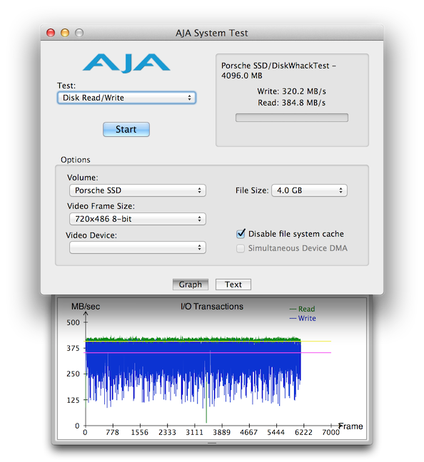

AJA System Test
My impressions? The drive looks awesome and is priced very reasonably considering single-platter HDD inside. Add top notch performance USB3.0 controller and you have a winner! A nice short USB3.0 cable is included.

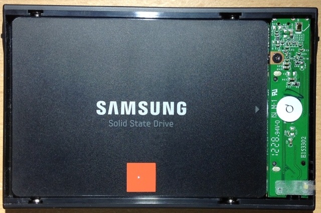

Is it easy to open up the lacie enclosure to replace the drive?
Not at all. All you need is to open two small plastic latches with thin soft plastic prying tools or even a pair of toothpicks.
P.S. The controller is ASMedia ASM1053

I've actually got 437 MB/s for reads with the same settings, so it seems to be on par. Writes in my case are capped by SSD itself (TLC memory, it's not a 840 Pro)

Our LaCie problems have usually been connector / PCB (they do seem well built, but don't seem to take much hard use...), and general HD failure that may be a mix of poor controllers and particular HD manufacturers. If you know the controller is good, and the USB connector /PCB looks well made, and you control the disk used, then all sounds good!!! :cool:
I think PCB is good (and very small as well). I'm using the drive as a system SSD at the moment and it will host VMs in near future as well.
Report: Even though the replacement drive (SM840 500GB) is supposed to peak at 5W or more during intensive writing, no issues with power draw from any of USB3.0 ports were observed. I know some users are skeptical about high-capacity bus powered SSDs, but it seems like a safe bet (at least with rMBP ports) as of now. Keep in mind, that according to this REVIEW, my SSD consumes slightly more than average modern MLC drive.
