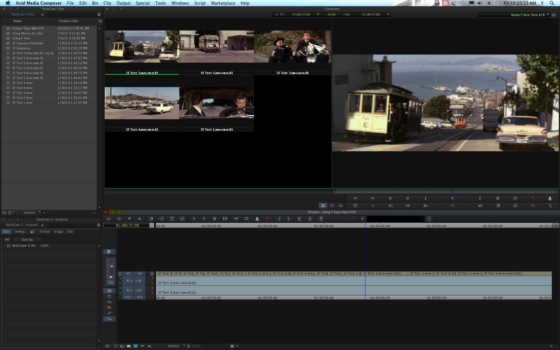

Also, if the max is reached within 4-6 cams, test again when the new engine is in MC8.
Of course it is not necessary to wait for a 4K multicam shoot. Attached is a screen shot using "5 cam" in HD. Simply edit the footage into x-amount of parts to simulate x-amount of cameras.
