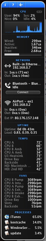

I have attached a screen capture of my Stat widget below
The slots and backside fans are always stuck at 76rpm and 51rpm. Also CPU A is normally at a high temperature than CPU B. I think the highest i've seen that temperature at has been about 75 but i don't look at it often. These stats were just when I was importing a CD into itunes fans were quietish.

This is what mine is like when they run normal.
