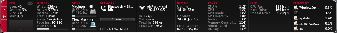

Here's my temp stats -- been running continuously for weeks, woke from sleep about an hour ago...
wow, some cool imacs on here, my temps are in farenheit, and no, those arent my highest, ive had the GPU diode up at 152, while i was playing doom 3, nothing intensive, and the airport card up at 149

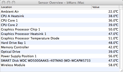

I've practically burned my hands on this machine, its insanely hot, from what i can feel, the upper left side is VERY HOT, also on top of the HD, the power board is also hot, and something else in the upper right corner, and no, it isnt the optical drive, what do you think of these temps?

I've practically burned my hands on this machine, its insanely hot ...
... what do you think of these temps?
If it's "insanely hot" on the outside, it's even hotter on the inside, as
your iStat Pro readout clearly indicates. I'd suggest smcFanControl
to try to get that HD temperature down into the "sane" range.
LK

uhhm, did you bother seeing the attachment?
