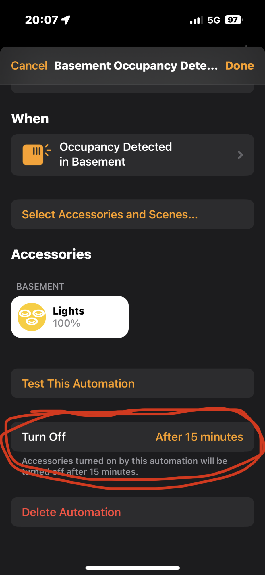

So you’re saying this feature works good for you? Hasn’t worked for me since like iOS 14.

Ok so you’re using this in a third party app. Doesn’t work well in the Home app. I’ve been experiencing the same thing as the OP (actually, the same exact automation as the OP) and it doesn’t go back after the set time period I have all the third party apps already so I’ll try there. I wanted to stay away from using scenes though with the 100 scene/automation limit. I have a lot of LIFX 4 gang switches that require them to use HomeKit scenes to turn on/off a light or whatever other accessory.

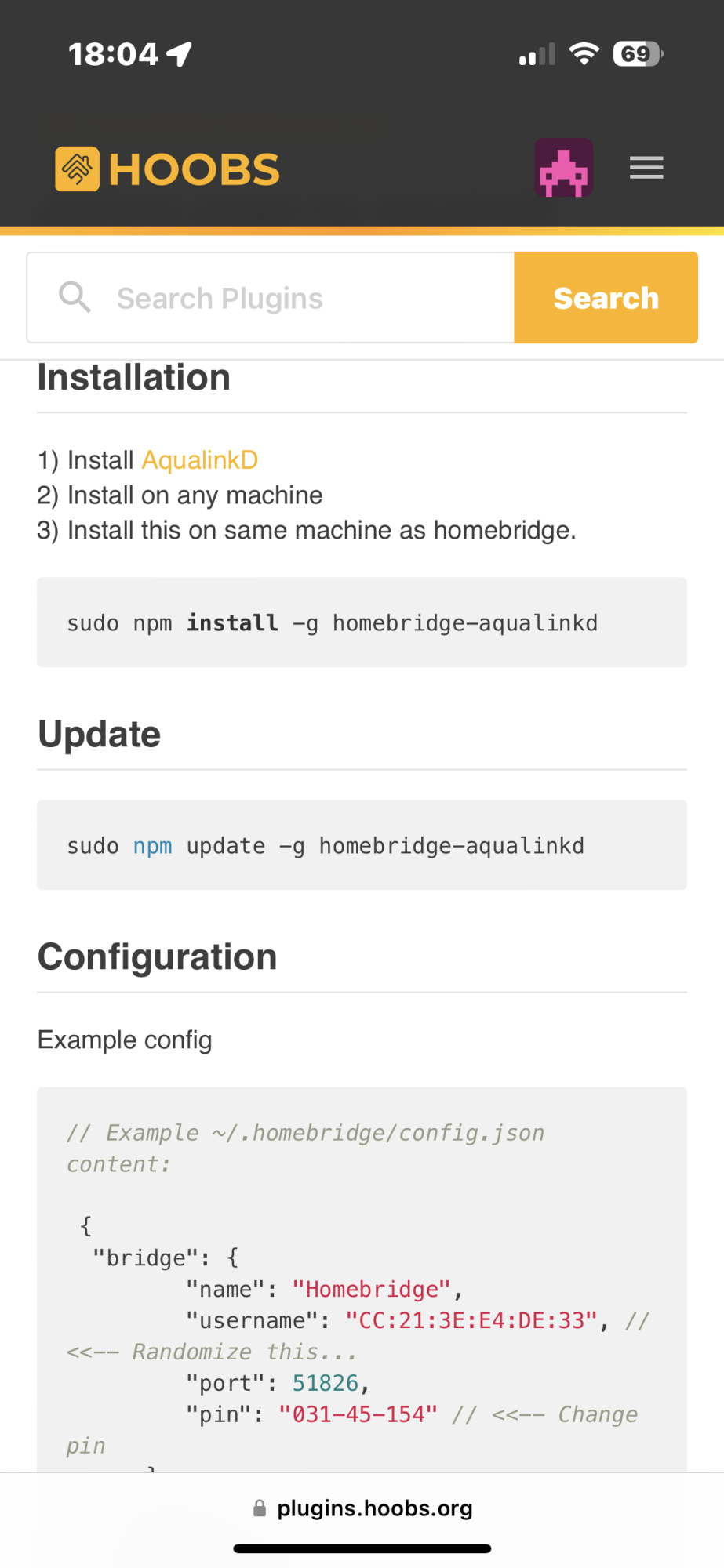

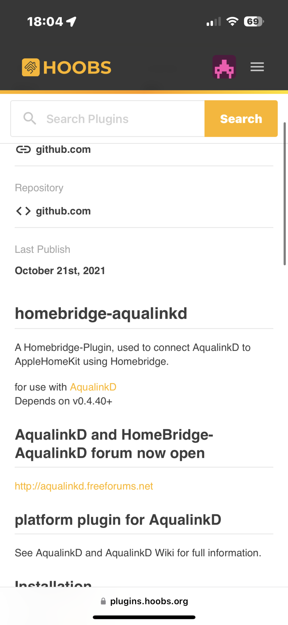

I’m not very savvy in coding and networking and all that stuff. Never had the time to learn it. I bought a HOOBs about six months ago and it’s still sitting in the box. Would love to start tinkering with HB but never really had the time. I supposed now’s a good time to get started.
I have experience with using smart outlets as dummy switches for automations- Opening garage doors, deactivating an alarm, unlocking locks, etc. Apple is supposed to just work but unfortunately that slogan has long since expired.

Funny, I actually bought a Mac back in 2018 for the sole purpose of trying HomeBridge, otherwise I don’t really have a need for one, and I still haven’t tinkered yet lol. Tried dumbing it down with HOOBs and well, that’s still sitting in the box, unopened. Now here I am, contemplating pre-ordering the new HOOBs for $400 lol.
I really gotta start getting into HB. I heard it needs a lot of babysitting and was hoping Matter would mitigate the need for HB. There is one plug in that I’m really interested in and if not for anything else, it would be worth it for this alone. Getting my pool equipment into HK- Aqualink RS. I know HOOBs has a plug in for this. Looks scary though and I’d pay someone to install it.

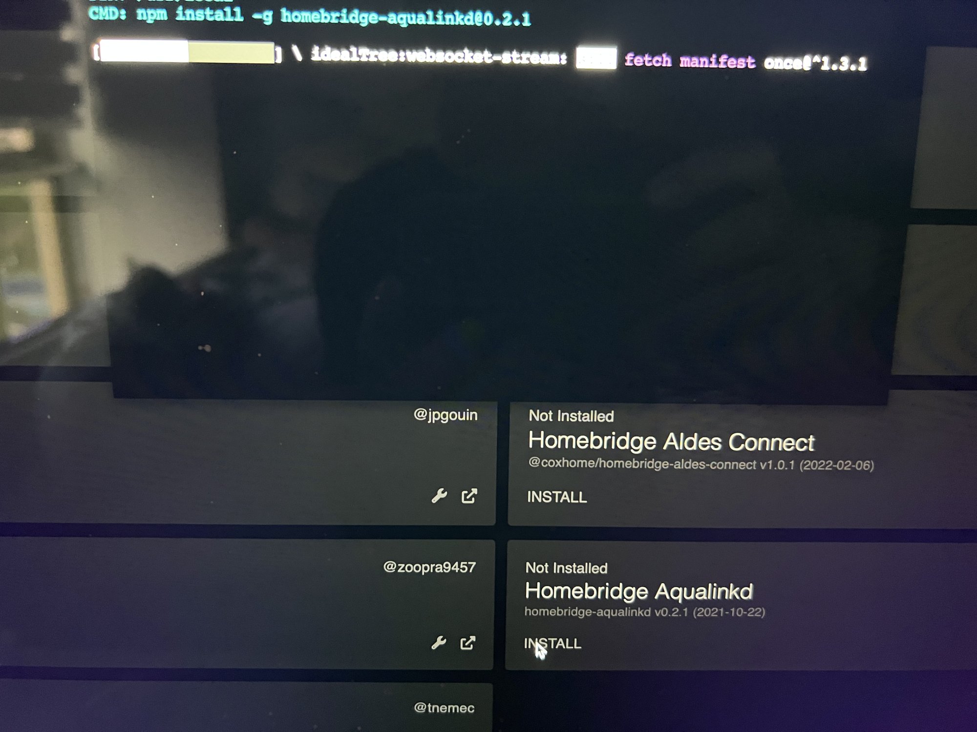

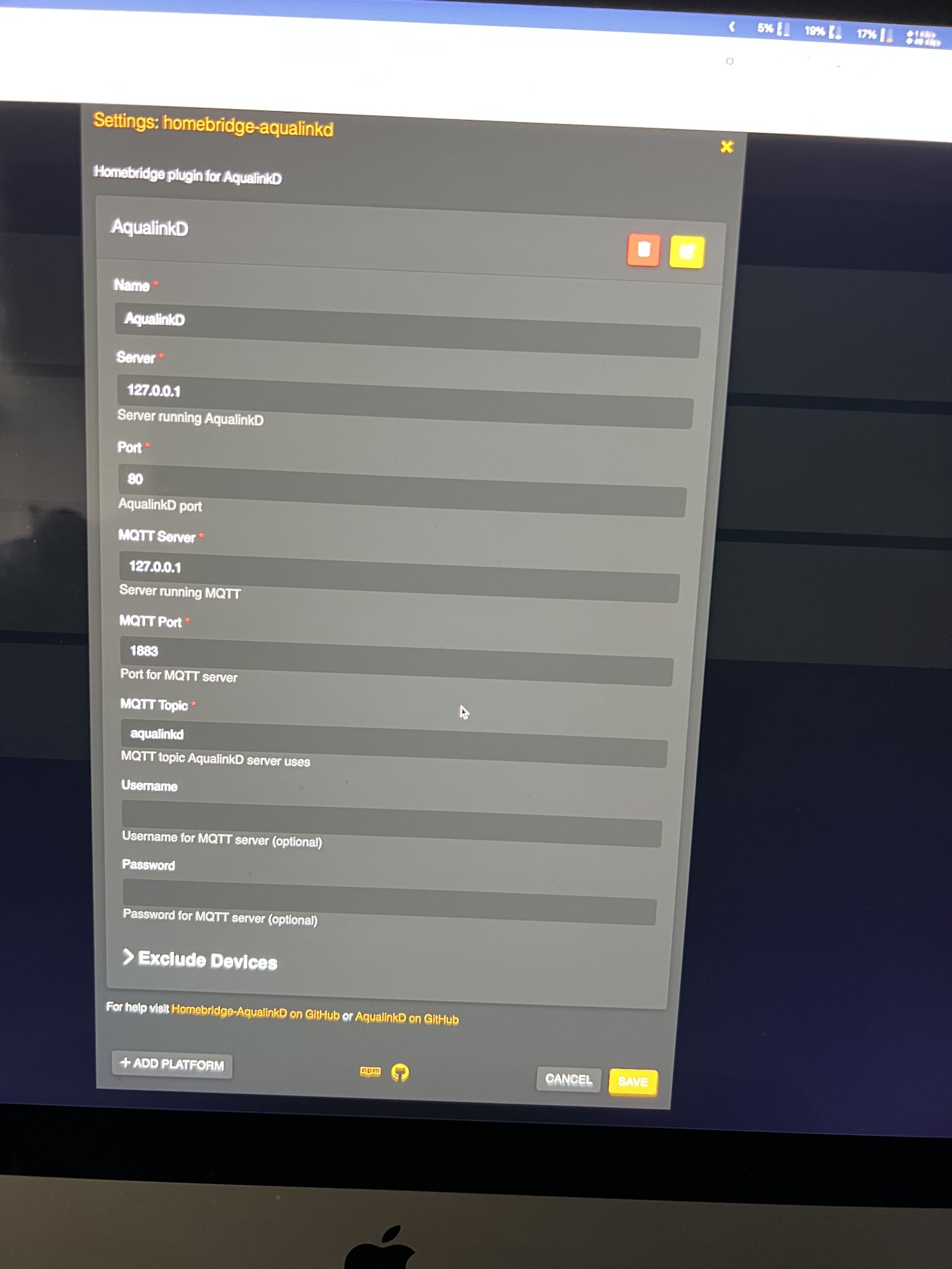

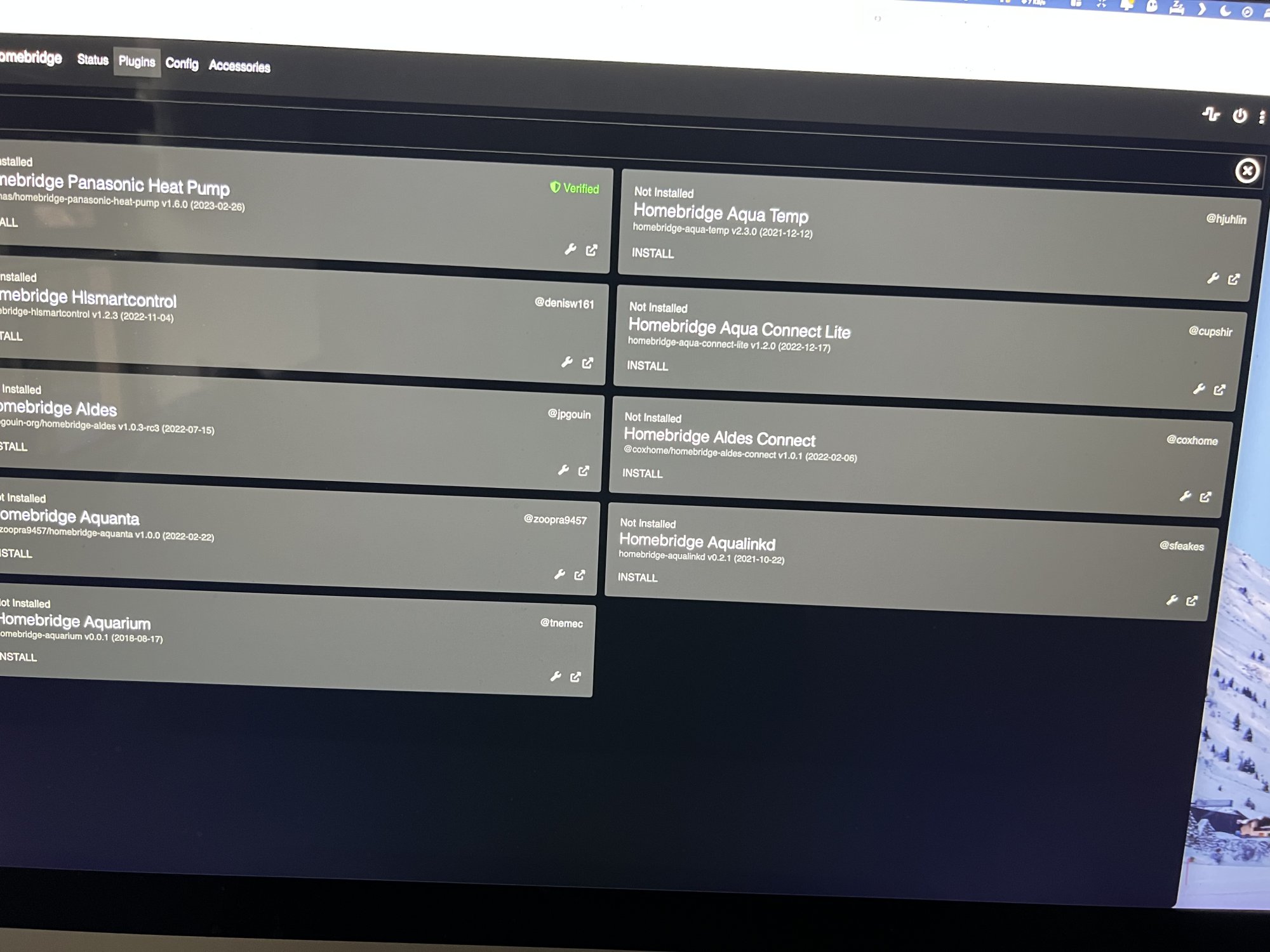

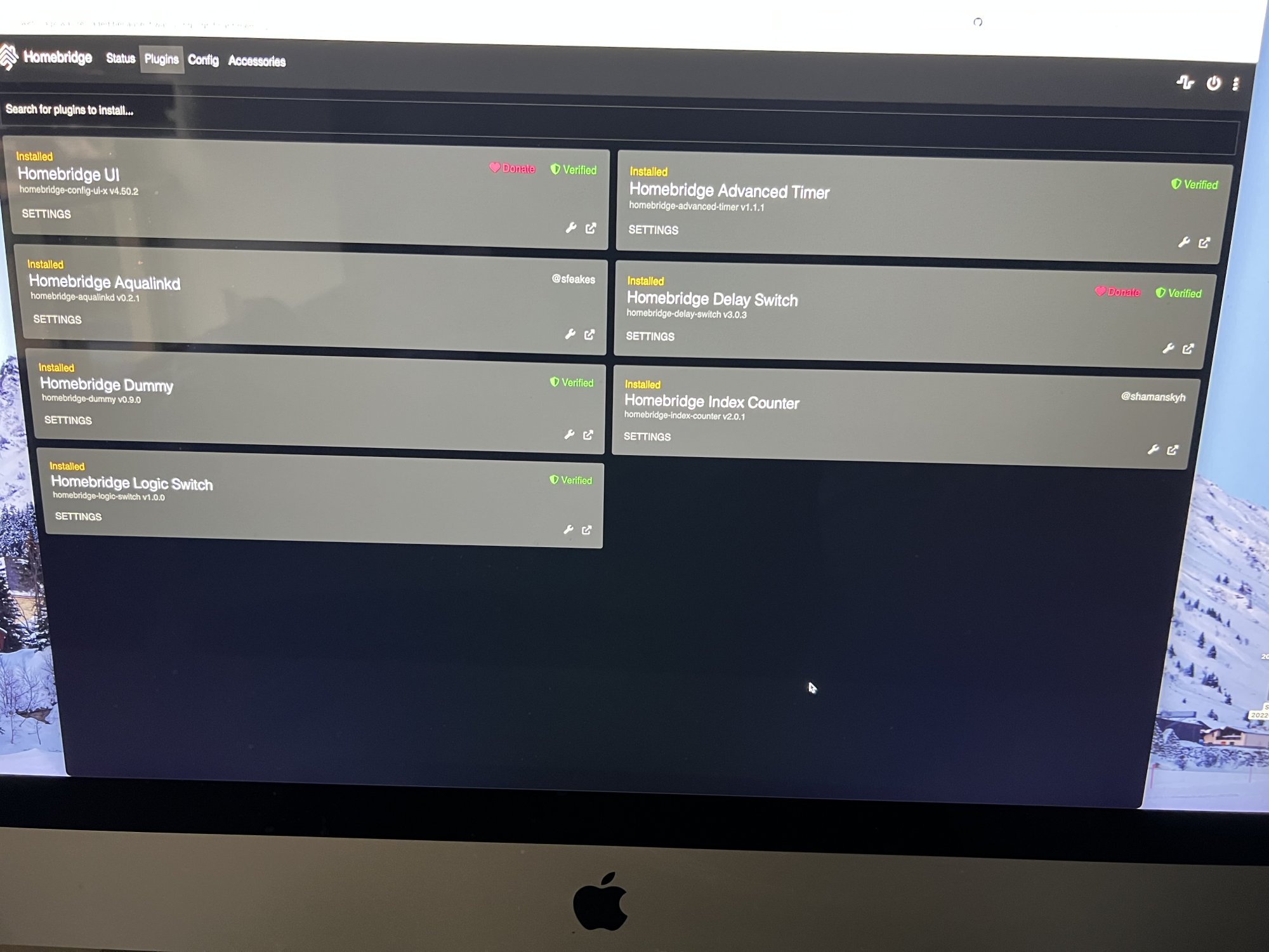

A340C8C2-DB7F-4443-A138-B624D853BC80.pngE2A83BED-80A5-4EF8-A237-9E2EAF0DA460.png25F8222F-12B1-4083-8988-324EC60AD72B.pngD1F13F9F-E934-4CB7-ADD0-0ECF0EA9375F.png6BD819D2-014F-46AD-A8C3-66B6F82F058B.png84BC299E-D582-4ED4-B1E2-E2673486250A.png

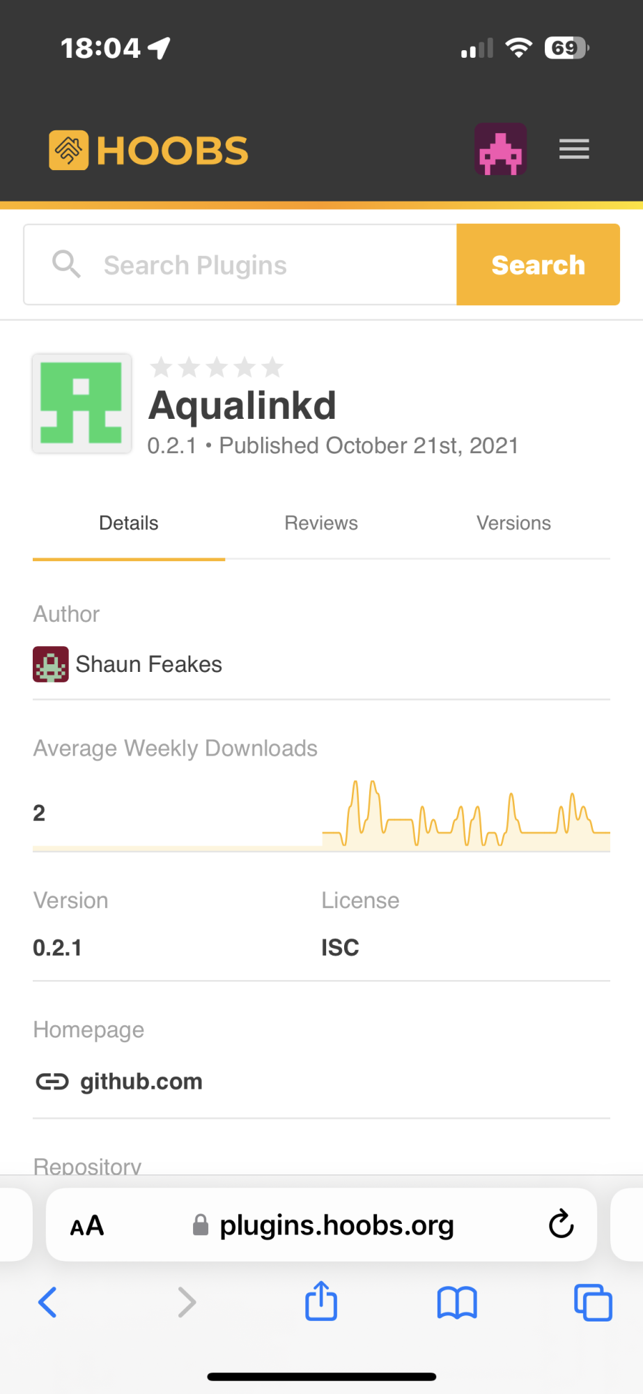

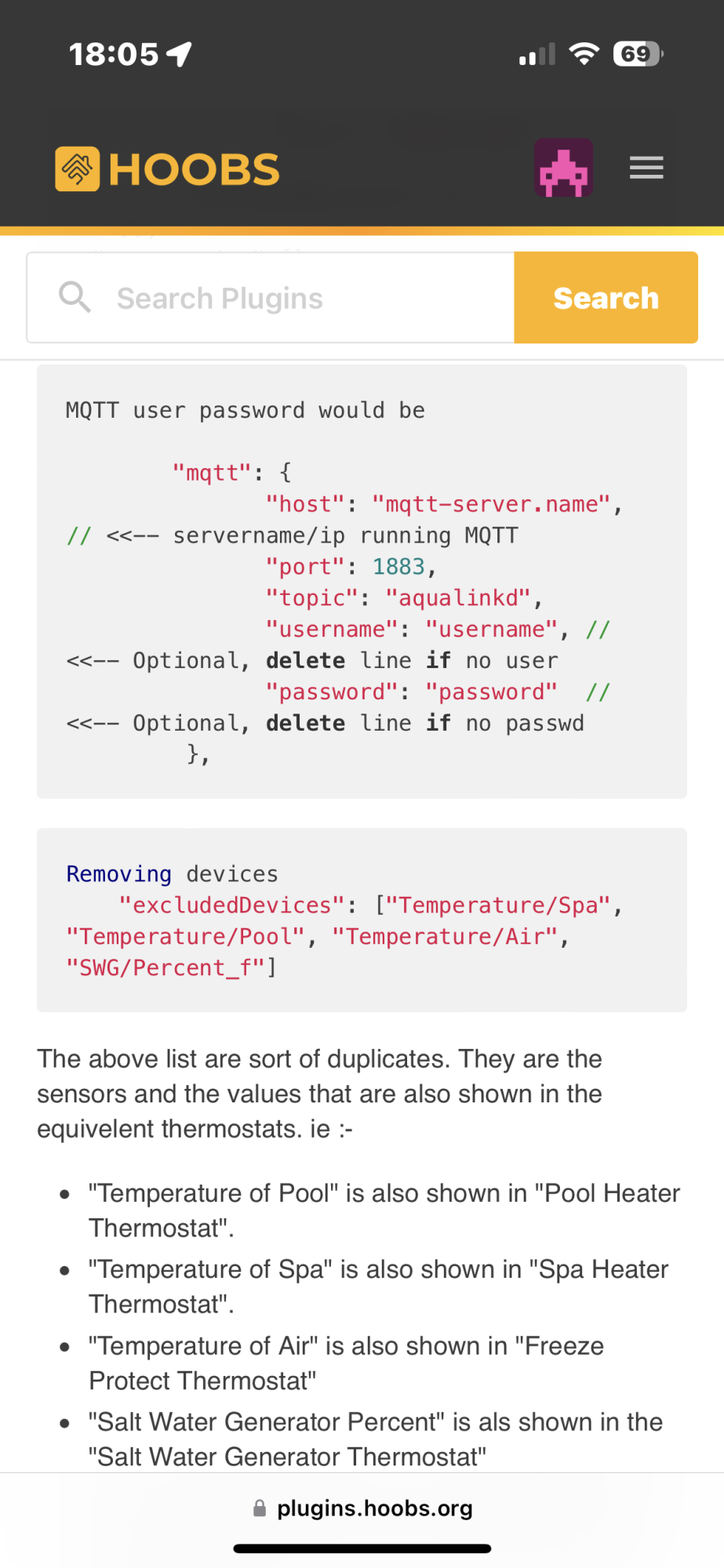

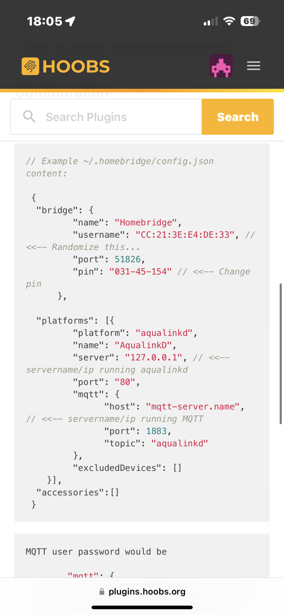

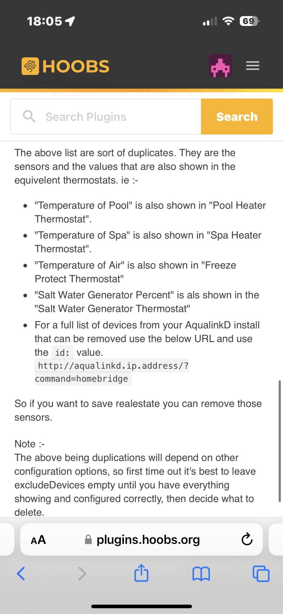

Don't worry about the coding and stuff on the plugin websites. That's just how the plugins were built or how they run. You won't be seeing any of that in Homebridge. I attached some pics of how to get and install the plugin and how you would set it up.
View attachment 2170579View attachment 2170584View attachment 2170581View attachment 2170582View attachment 2170583

So that’s basically it? Just hit “install” and done? Surely, there’s gotta be more to it lol.
Thank you much!!!
That’s how you install the plugin, yes. 🙂 The coding and Jason files examples on the plugin description pages are a bit misleading. After the easy installation you can set up the required parameters. Happy experimenting!
