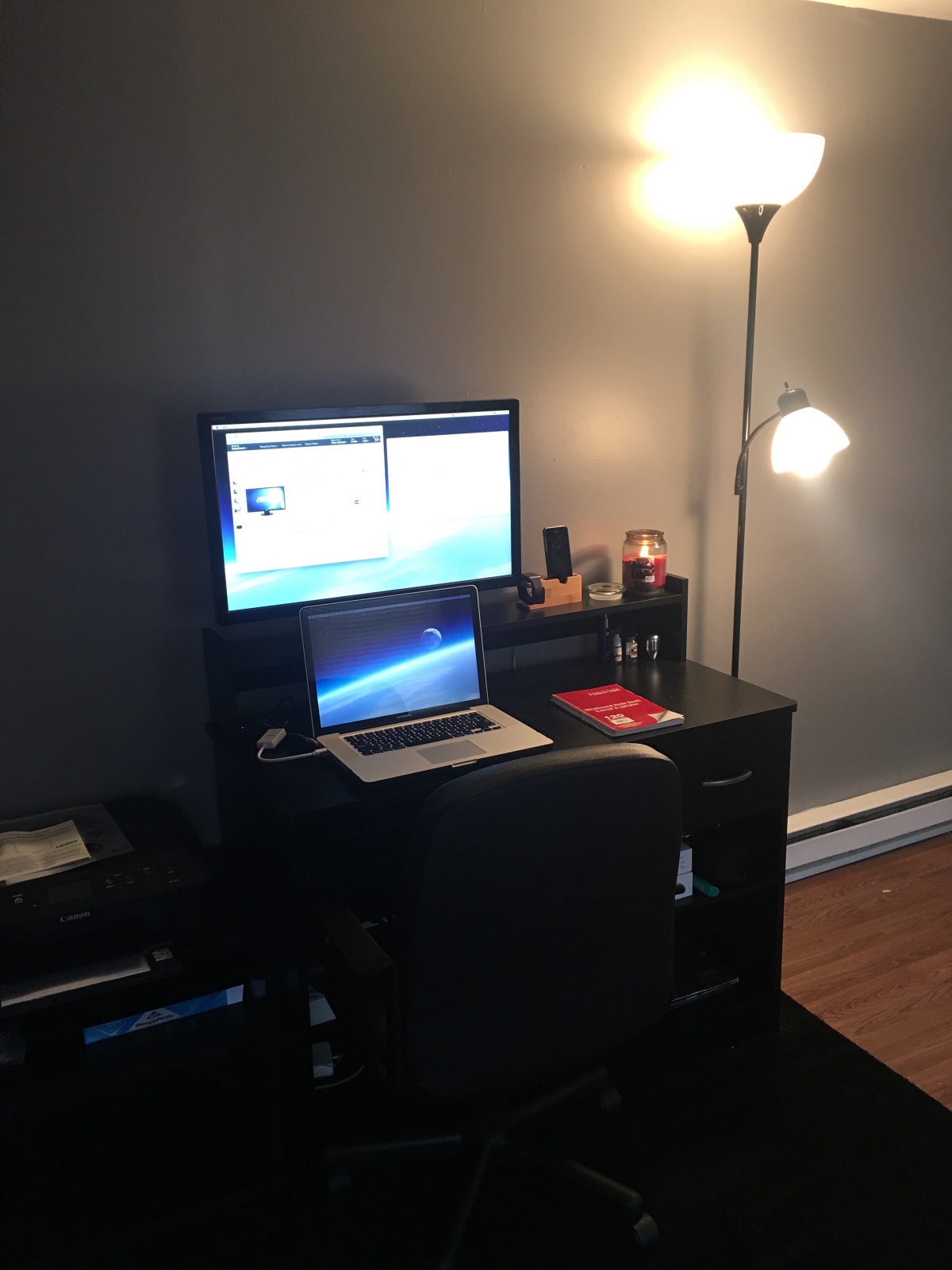

Definitely worth the money. The monitor can hang off the edge of the desk, so I can easily order another one.
