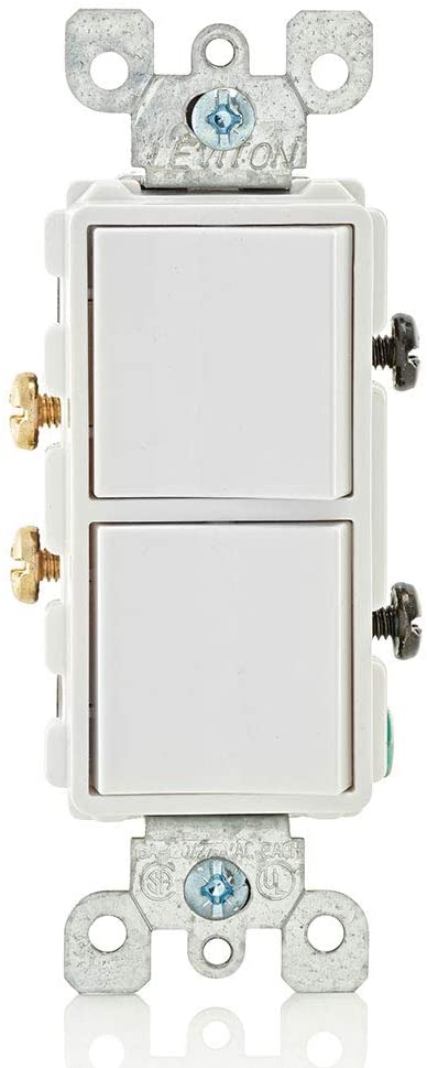

Sorry, not sure about the correct terminology. I guess what I'm looking for is a “two-pole” single gang switch. Something like this, but homekit compatible: https://www.amazon.com/Leviton-5634...ommercial/dp/B003AVLWGM/ref=asc_df_B003AVLWGM

Thanks Barbu. I currently have a few Meross switches. 2 dimmers, 3 standard switches and even a couple of outdoor plugs I use for my Holiday lights. In my opinion they are the among the best ones out there for the money. But they currently don't make one with a double switch (not a 3-way) which is what I'm looking for.
Ooos my bad, I didn’t study the photo closely enough, did not notice the two mini switches. That is a different thing altogether… I hope you find one OP!
Thanks for the link! I actually had purchased that before started this thread. I had done an amazon search for a 2-gang switch and those came up. My mistake in not fully reading the description. I saw the two buttons and thought it was what I needed. Turns out one button turns on, the other turns off. Thankfully Amazon has a good return policy. 😀
