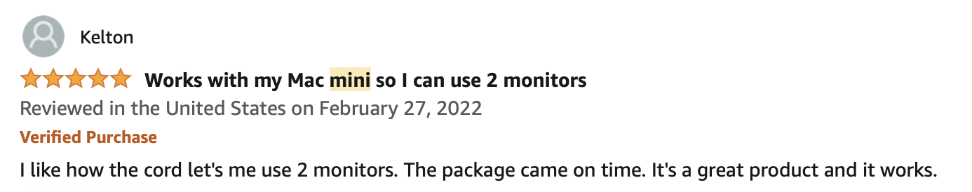

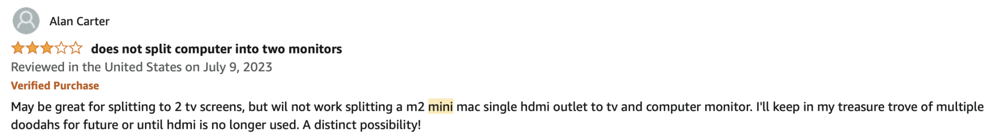

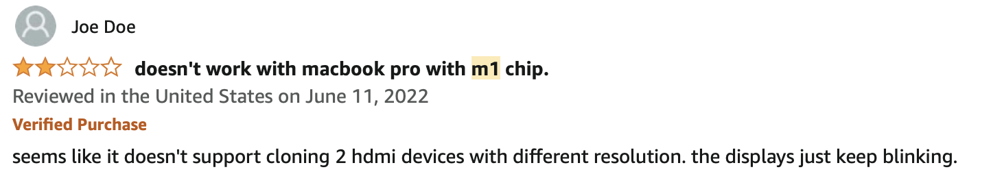

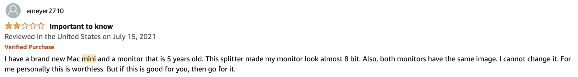

If you do try it, let us know if it works for you. The Amazon reviews on this, for those who tried it with a Mini, are all over the place. If it were to guess, it looks like it *might* work if both displays have identical frame rates and resolutions, and if you don't mind a reduction in picture quality:
and here's one with an M1 Pro:
